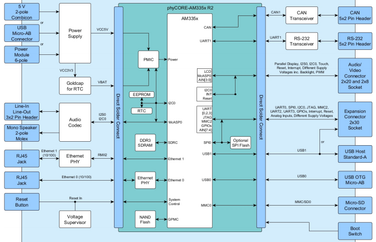

I added attachment with block diagram of my custom board with information about ethernet PHY.

    Earlier, I added picture of block diagram of my custom board, and below I attached device tree:

    As I can see: first port is working in rmii mode, second is working in mii mode.
    So I changed code to:
        SOCCtrlCpswPortMacModeSelect(1, ETHERNET_MAC_TYPE_RMII);
        SOCCtrlCpswPortMacModeSelect(2, ETHERNET_MAC_TYPE_MII);
    Both ports of TI bbb AM335x board are working with mii mode, so it is next difference.
