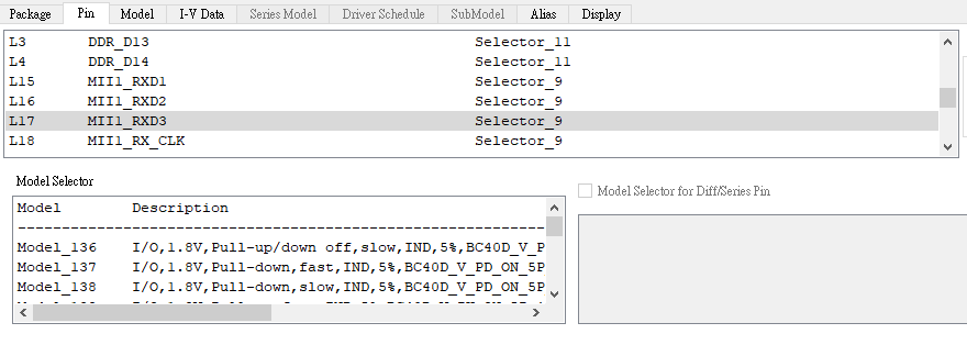

AM3354: Does AM3354 IBIS model support to do RGMII simulation?
Part Number: AM3354
We use two RGMII interface for Ethernet PHY and would like to do simulation because layout trace is too long.
We find it has MII model on those pins which we used as RGMII signals, but no RGMII model.
BR,
Yume

  • Hi Shriram,
    Attached is the IBIS model we used.
    BR,
    Yume
    https://e2e.ti.com/cfs-file/__key/communityserver-discussions-components-files/791/sprm552c_5F00_AM335x-ZCZ-IBIS-Model-_2800_Rev.C_2900_.7z

  • Hi Shriram,
    Yes, we have found many model selector on the MII pins.
    But not sure which one we should use for RGMII.
    For example, Pin L17, it has model 136~ model 159 as attached file.
    BR,
    Yume

    Here are some more details which should guide selection of appropriate RGMII I/O models.
    Please choose these depending on your specific application:
    IO mode: 1.8v or 3.3v.
    IO slew: Fast or slow. RGMII should only allows for fast slew.
    Supply:  5% or 10% variation.
    Weak pulls on the I/O: Both disabled, pull up enabled or pulldown enabled. Pulls should be disabled for RGMII.
    regards,
