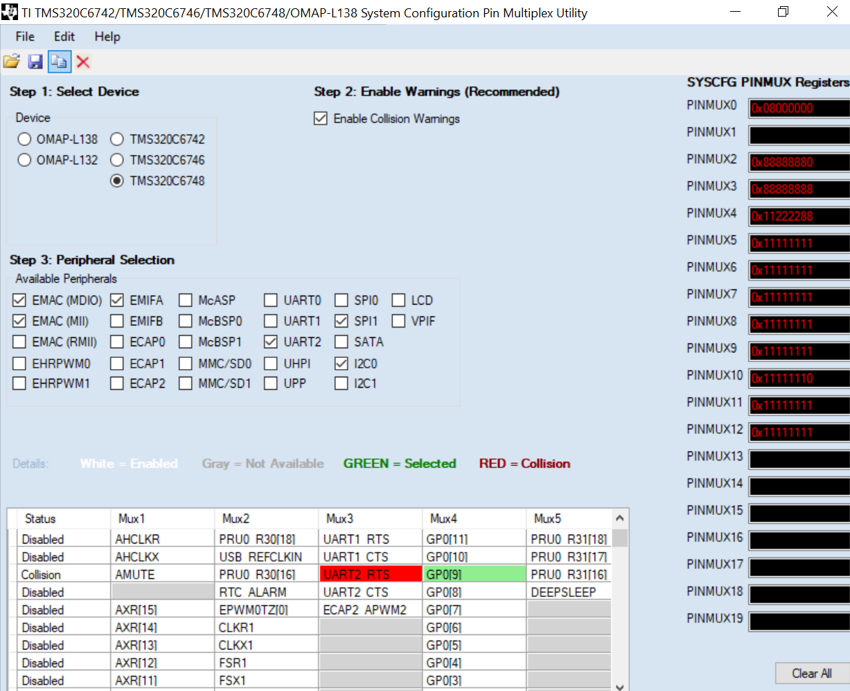

    As I have not any feedback from you and I need to advaced in this topic, I have retaken the issue. After reading in many some posts, I have realized that there is a a tool called "TI Pin Multiplex Utility.exe" use dto define the pins needed for the application.
    In my case I need to control:
    D6, on pin GPIO2-12
    D7 on pin GPIO0-9
    So in Pin multiplex tool I have chossen GP0[9] and GP2[12]. (In figure below you can see how I have defined GP0[9])
    Whit this tool I also can save this file as a .h header file.
    Then:

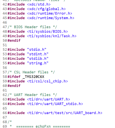

    What should I do with this file? Shoud I replace this new .h file for a .h file in the “GPIO_LedBlink_lcdkOMAPL138_c674xTestProject.”?  next figure shown includes of the project.
    Once that I have this done, what other part of the code should I modified/add to define the GPIO2-12 and GPIO0-9?
    Thanks in advance,
    Joaquin.

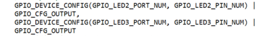

    (3) Modify file: "C:\ti\pdk_omapl138_1_0_11\packages\ti\drv\gpio\test\led_blink\omapl138\GPIO_board.c. " to defne the new GPIOs as outputs

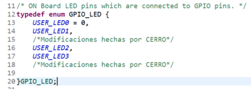

    (4) Modify: "C:\ti\pdk_omapl138_1_0_11\packages\ti\drv\gpio\test\led_blink\src\GPIO_Board.h " two add two new lines defining USER_LED2 and USER_LED3
    This is the part more confussing for me, because in my understanding, in this function, names are associated sequentially with the above definitions. Maybe someone can explain this a little bit better.

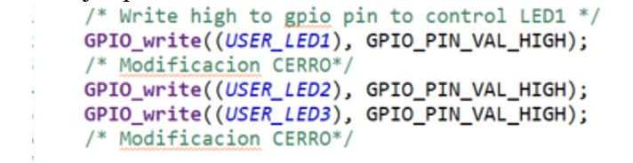

    (5) finally I can modify the main-c file to fix a initial value for the new pins and then toggle them on the callback.
    An togle on the callback
