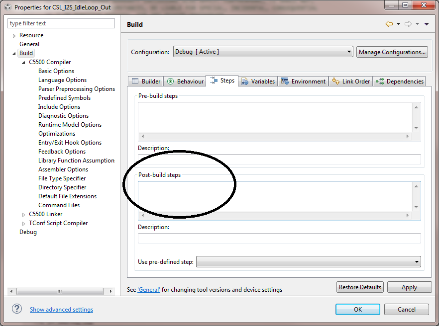

    Is there a way to modify the hex55 command line within CCS.  Currently the process is:
    1. Build the "app.out" file from CCS.
    2. Open a command line window and run the new hex55 command line to generate the "app.bin" file.
    Robert
      You can try adding the command in the ' post build steps using" CCS.
      Attached image as the details. Hope this works.
     Vasanth
