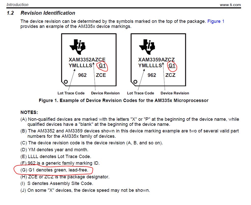

Which grade is the product in the attached file?
please let me know the information.

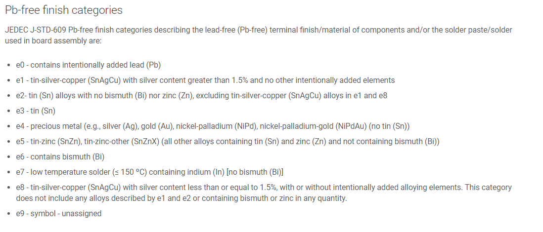

I found useful information on ti.com at the link https://www.ti.com/support-quality/environmental-info/logo-product-labeling.html?keyMatch=J-STD-609&tisearch=Search-EN-everything .
The key detail here is this:
You will find the "G" code for AM3358 in the device errata : https://www.ti.com/lit/pdf/sprz360. Here is an extract:
So, you can see that the AM3358 is marked G1 which is equivalent to category e1 in the JEDEC J-STD-609 specification.
