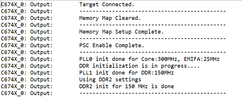

(1) On CCS  Version: 10.2.0.00009, I build and run "GPIO_LedBlink_lcdkOMAPL138_c674xTestProject" example project that I got when installed "ti-processor-sdk-rtos-omapl138-lcdk-06.03.00.106-Windows-x86-Install.exe". I see how D4 and D5 toggling according to the demo. Picture below is how the target is connected in CCS

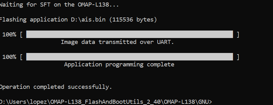

Then I use command:
sfh_OMAP-L138 -erase -targetType C6748_LCDK -flashType NAND -p COM4 (Operation completed successfully.)
Then I flash NAND
sfh_OMAP-L138 -flash_noubl D:\ais.bin -targetType C6748_LCDK -flashType NAND -p COM4

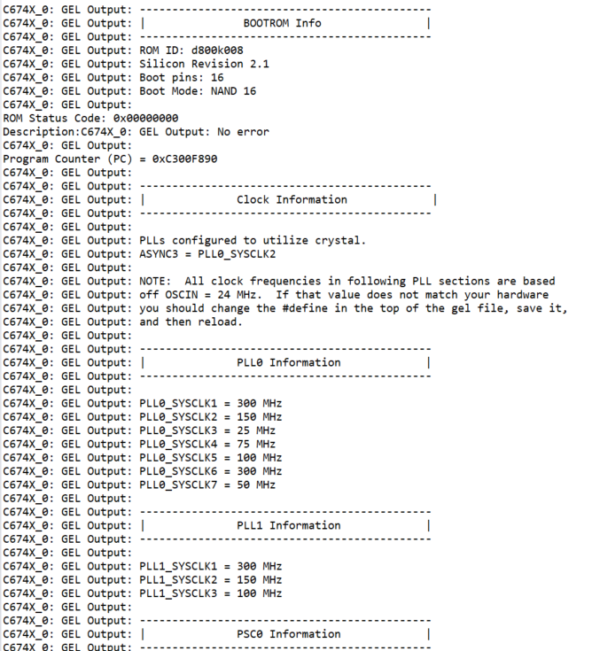

In CCS I also run Scripts> Diagnostics>Run_All, after loading a GEL (C:\ti\ccs1020\ccs\ccs_base\emulation\boards\evmomapl138\gel\OMAPL1x_debug.gel) and can assure it is booting NAND 16.
Please could yo tell me if I am doing something wrong?
