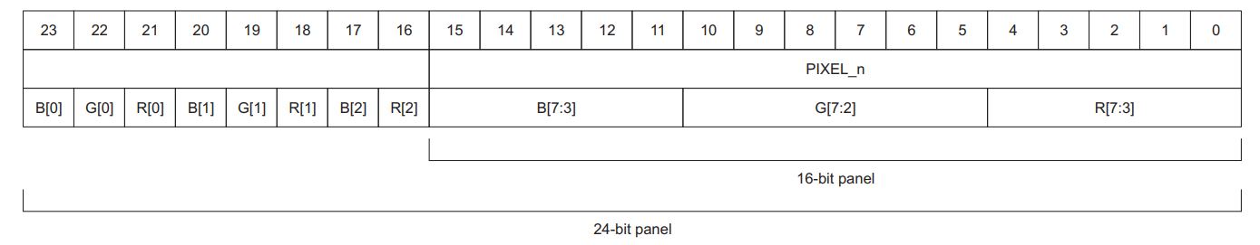

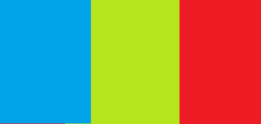

    With regards to the color swap, please refer to the silicon errata (3.1.1 LCD: Color Assignments of LCD_DATA Terminals). The blue and red color assignments to the LCD data pins are reversed when operating in RGB888 (24bpp) mode compared to RGB565 (16bpp) mode. I am not sure about your configuration but for one of our boards we added a special entry in the dts file to compensate for the above errata.
    I would also recommend running kmstest and it shows various color bars on the display. The first three color bars should be red, green and blue.

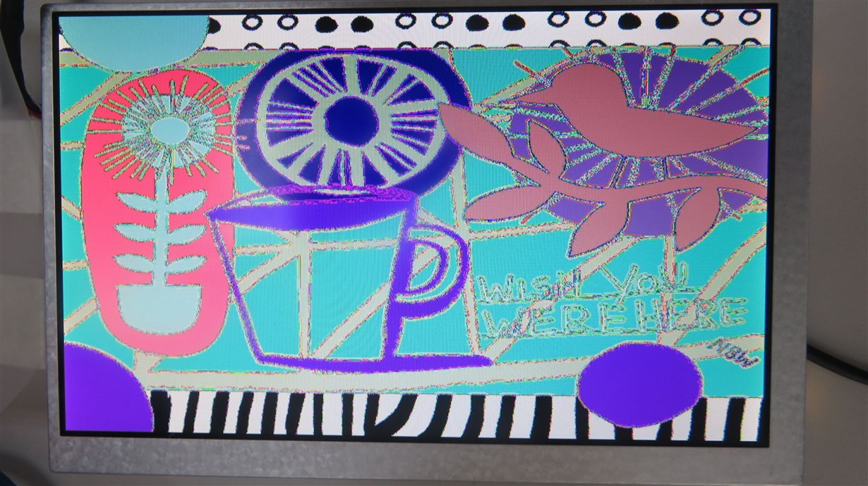

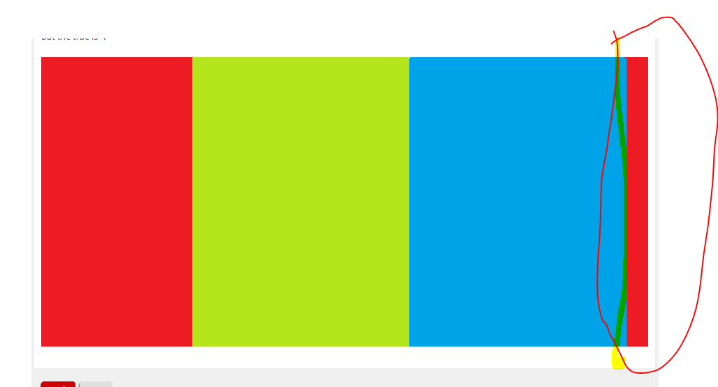

    I plan to show pictures in another LVDS, but part of the picture turns green。

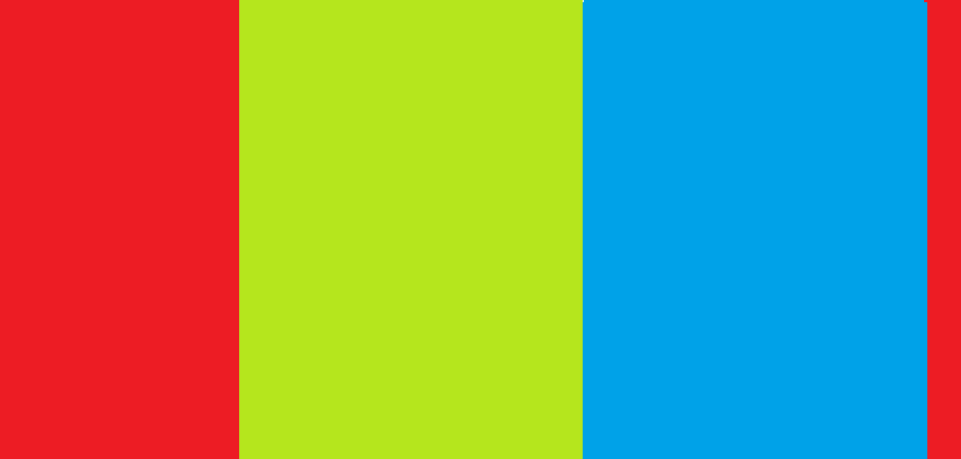

    when I use the kmstest, The colored bands in the image are not shown properly, and I can see that each ribbon is made up of long strips of different colors. The border that should have shown blue shows purple, and the border that should have shown red shows green.
    Please share the picture of the output image. Also, if possible, more information about your LCD HW connection.

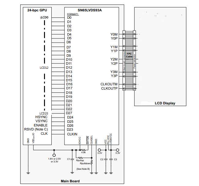

  • 1. It can output normally
    2. I have another board, other circuits are basically the same, but in the display part, I use sn65lvds93adggr with another screen. The circuit is recommended by sn65lvds93adggr.
    3. The output image of kmstest is as follows
    4.Tomorrow I'll try to see if I can use rwmem
    Please correct me if I am wrong but it seems like you have 2 different displays. The first display works and the output image is as expected. However, the second display has issues based on the above kmstest output. How does the output of gstreamer look like for the non-functional display?
    With regards to the HW connection, both displays are 24 bit and do they come from different vendor?
    Krunal

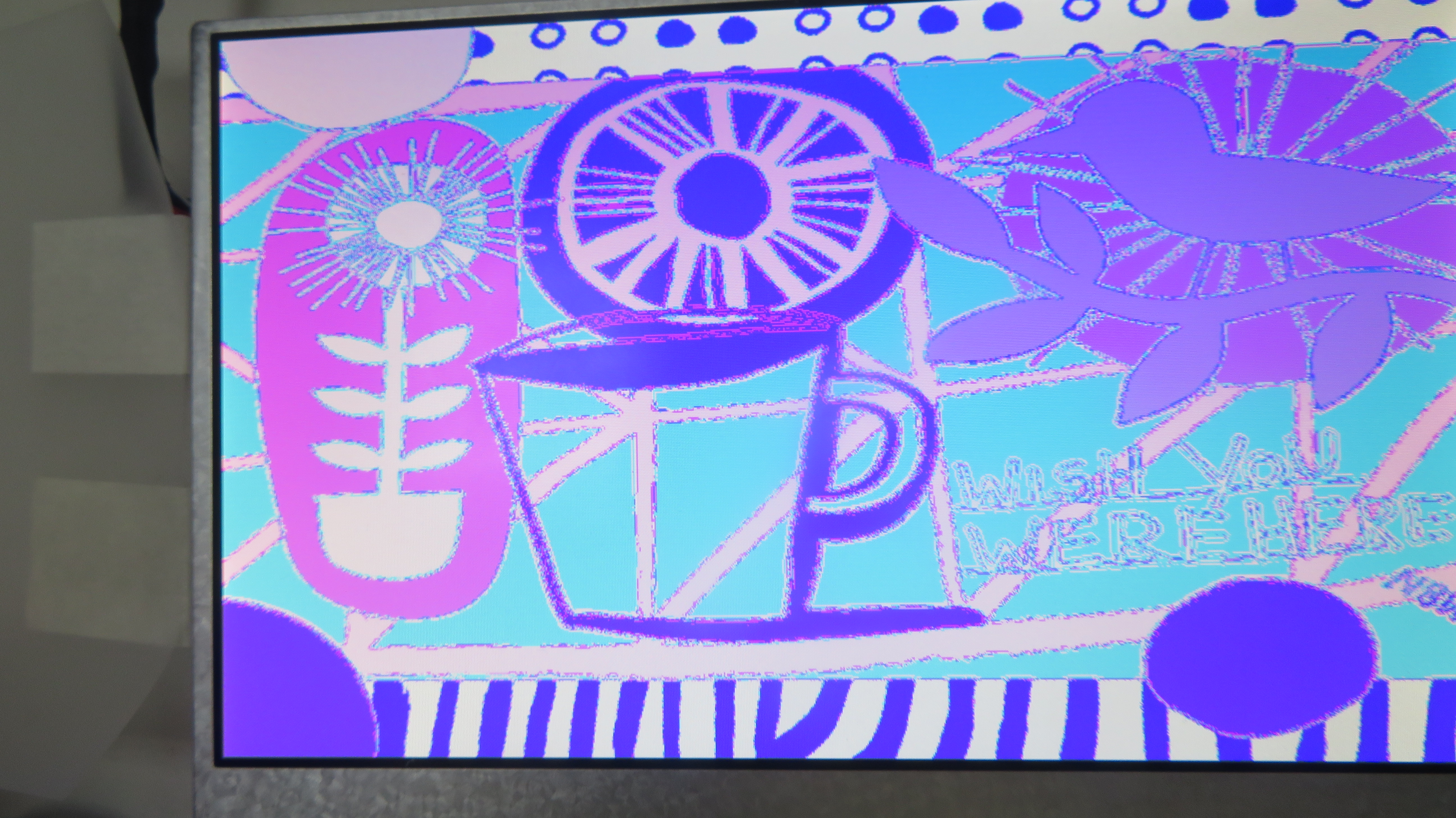

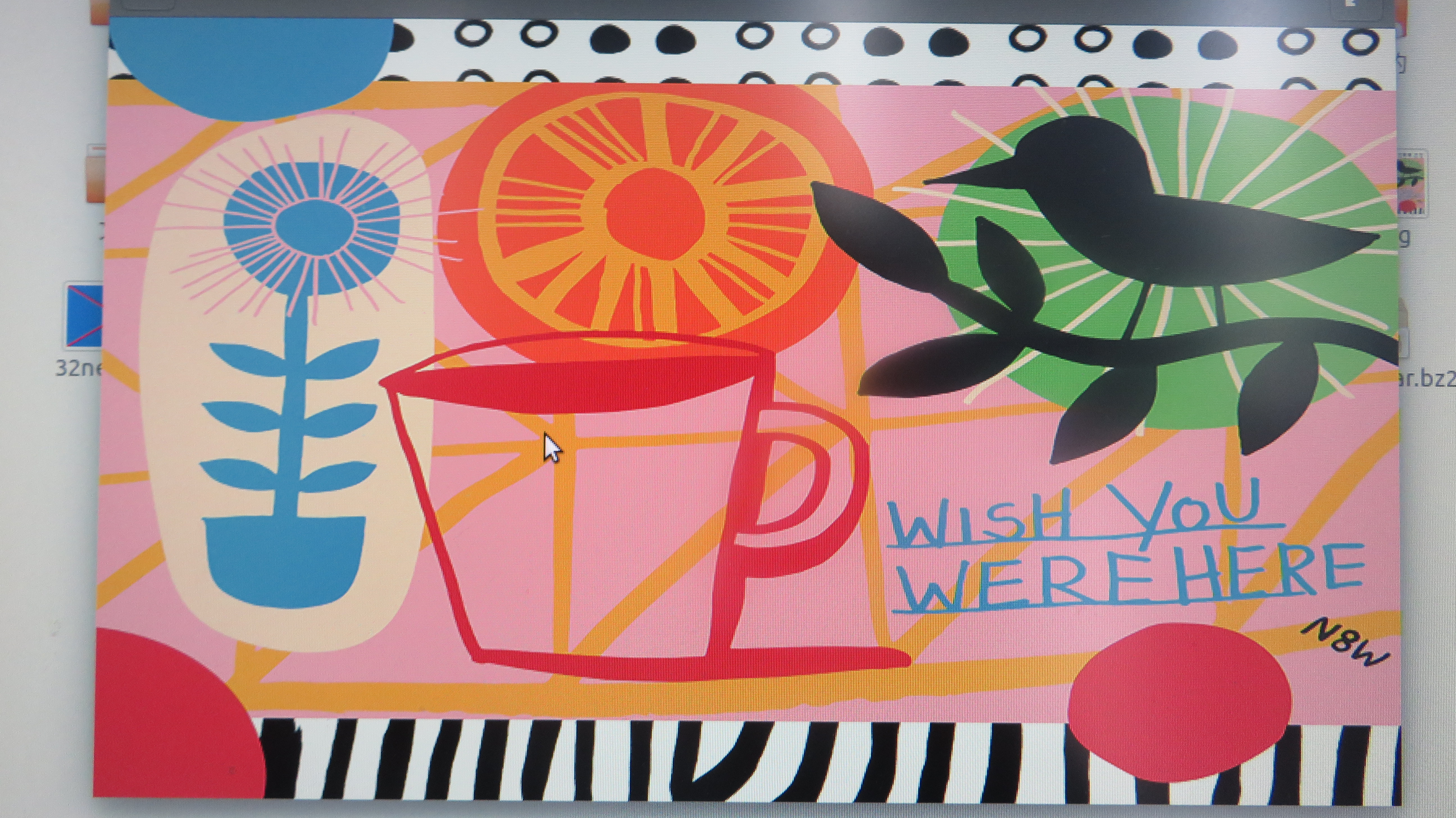

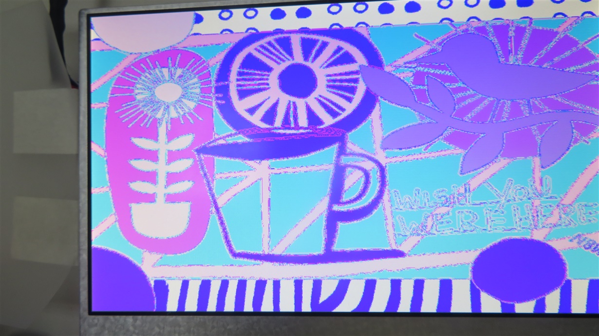

  • use
    gst-launch-1.0 filesrc location = / boot / 09.png!pngdec!videoconvert!imagefreeze!kmssink driver-name = tilcdc
    The original picture is
    and the display show
    the first display is 16bit and in RGB mod,the second display is 24bit and in LVDS mod.They are from different manufacturers.
    As mentioned in our silicon errata, the blue and red color assignments to the LCD data pins are reversed when operating in RGB888 (24bpp) mode compared to RGB565 (16bpp) mode. I am wondering if you have added the property "blue-and-red-wiring = "crossed"" in your lcdc node. We have done something similar on our dts configuration: https://git.ti.com/cgit/ti-linux-kernel/ti-linux-kernel/tree/arch/arm/boot/dts/am335x-evmsk.dts?h=ti-linux-4.19.y#n756
    Krunal

  • Hello.
    Is the LVDS hardware connection (lcd0-d0 ~ lcd22-d22, lcd23-d27) correct?
    Before we check the HW connection and LCD configuration, could you please run the rwmem? It will tell us if the image going to LCD is corrupted or not.
    Krunal
  • thanks.
    the second board is sure that HW connection is wrong.
    I am checking internally and I will get back to you.
    Krunal

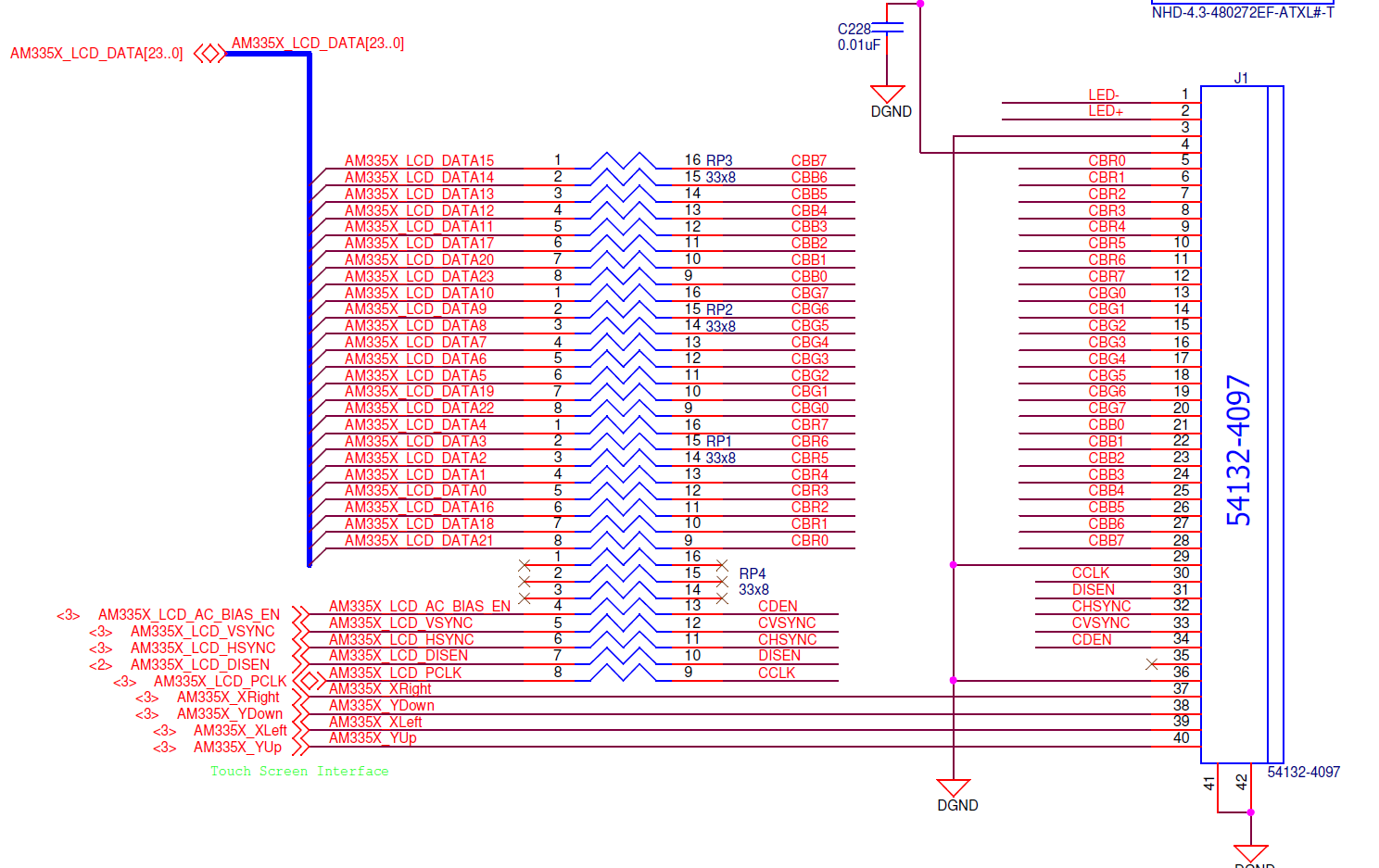

    Here is a reference of how we connect the 24bit LCD to our SoC:
    I am wondering if it is possible for you to configure your LCD as shown above. Also, if you plan to use the above configuration, please add the following to your software ""blue-and-red-wiring = "crossed"".
    Krunal
  • I will try that.
    I've added " blue-and-red-wiring = "crossed" " to  am33xx.dtsi ,Do I need to add it to am335x.dts?
    I recommend adding it to the dts file and only add the above statement after modifying your board. Also, please make sure the timing values for the LCD match the panel datasheet.
