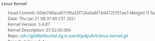

The release notes mention an RT kernel: https://software-dl.ti.com/processor-sdk-sitara/esd/am64x/latest/exports/docs/devices/AM64X/Linux_Release_Notes.html
I'm not 100% if the information from the release notes is correct though, since the version numbers don't match:
root@am64xx-evm:~# uname -a
Linux am64xx-evm 5.4.91-g1af1264b70 #1 SMP PREEMPT Thu Jan 28 20:42:53 UTC 2021 aarch64 GNU/Linux
The release notes say the kernel ought to be version 5.4.87:
I'm also slightly worried since the Repo listed for both the normal Linux Kernel and the RT kernel refer to a TI-internal git server, not to the public git.ti.com server.

  • Hi Dominic,
    The Linux kernel in this Processor SDK v7.02 release has one more patch on top of the information in the Release Notes - the patch disables the ADC in board DTS for Linux, because the ADC is used by R5F for the Benchmark demo.
  • Hi Bin,
    I believe there's still something missing.
    If I check out the commit listed in the relase notes I end up with a tree that is apparently 5.4.87 (e.g. the top level Makefile says SUBLEVEL = 87) and that contains a considerable amount of differences compared to the linux-5.4.91+gitAUTOINC+4f9a563c39-g1af1264b70 tree that comes with the installer.
    Since the prebuilt kernel says it is 5.4.91, too, I'm guessing that this is indeed the correct version.
    It seems that commit 4f9a563c39fa95af40d8f3119a64c347cbca3b45 was used as the base for the Linux kernel released with SDK 07.02 for the AM64x. The only difference between that commit and linux-5.4.91+gitAUTOINC+4f9a563c39-g1af1264b70 is a change to the DTS that disables ADC, like you said.

  • Hi Dominic,
    I think you are right, the kernel prebuilt and source code packaged in the Processor SDK v7.2 release are not aligned with the Release Notes. It seems the SDK has taken the HEAD of ti-linux-5.4.y branch (which has kernel v5.4.91 merged at the time of packaging) then added the ADC DTS change, not the release tag 07.02.00.004. I will confirm this internally.
