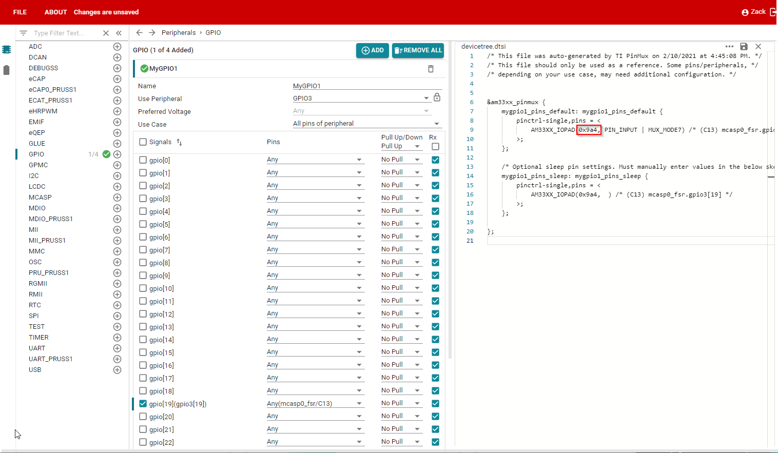

  • Hello Sébastien,
    You may require higher-level access rights in the HLOS to directly modify the PADCONFIG registers. What is the result when using sudo devmem?
    Can you verify the information in your .dtsi file?
    When I configure C13 in the SysConfig-PinMux Tool I receive the following line for .dtsi output.
    AM33XX_IOPAD(0x9a4, PIN_INPUT | MUX_MODE7) /* (C13) mcasp0_fsr.gpio3[19] */
