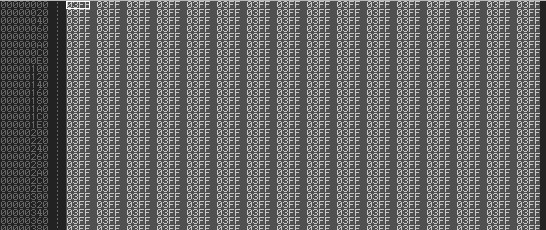

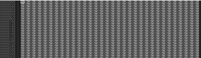

We are working on TDA4 EVM with a 10-bit RAW linear sensor. When the input RAW image is completely saturated, we observe that in the RAW image pixels are 0x3FF. In the YUV output with the ISP configuration being Rawfe PWL LUT enable set to 0, NSF4 being bypassed, GLBCE bypassed, CFA  LUT_enable being set to 0, EE_mode being set to 0, we are observing that the pixel value is limited to 0x7F and its not reaching 0xFF.
Raw Image data
YUV image data
When we enable GLBCE at a strength of 1, we observe that the value of saturation is increasing with it. We have verified the input bit width configuration in different ISP blocks and they are set to 10bits.
Processor SDK version is 7.0. We use single cam application. Can you please give us pointers to debug further. Could please let us know if we are missing configuring any ISP blocks?
