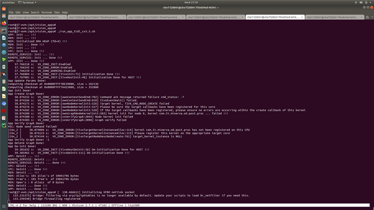

I am trying to create new vision application where we have new kernel (initially given by Shyam), able to use it and run the application fine on simulator.
On EVM I am getting kernel not registered for c66 core issue.
Please let me know how to register a new kernel for target and share me any example which I can refer if possible.
  • Hi, Sorry issue is happening at previous node where we create graph for TIDL network.
    Have enabled #define TIVX_TIDL_TARGET_DEBUG and please find the error log below.
    0412.Errorlog.txt

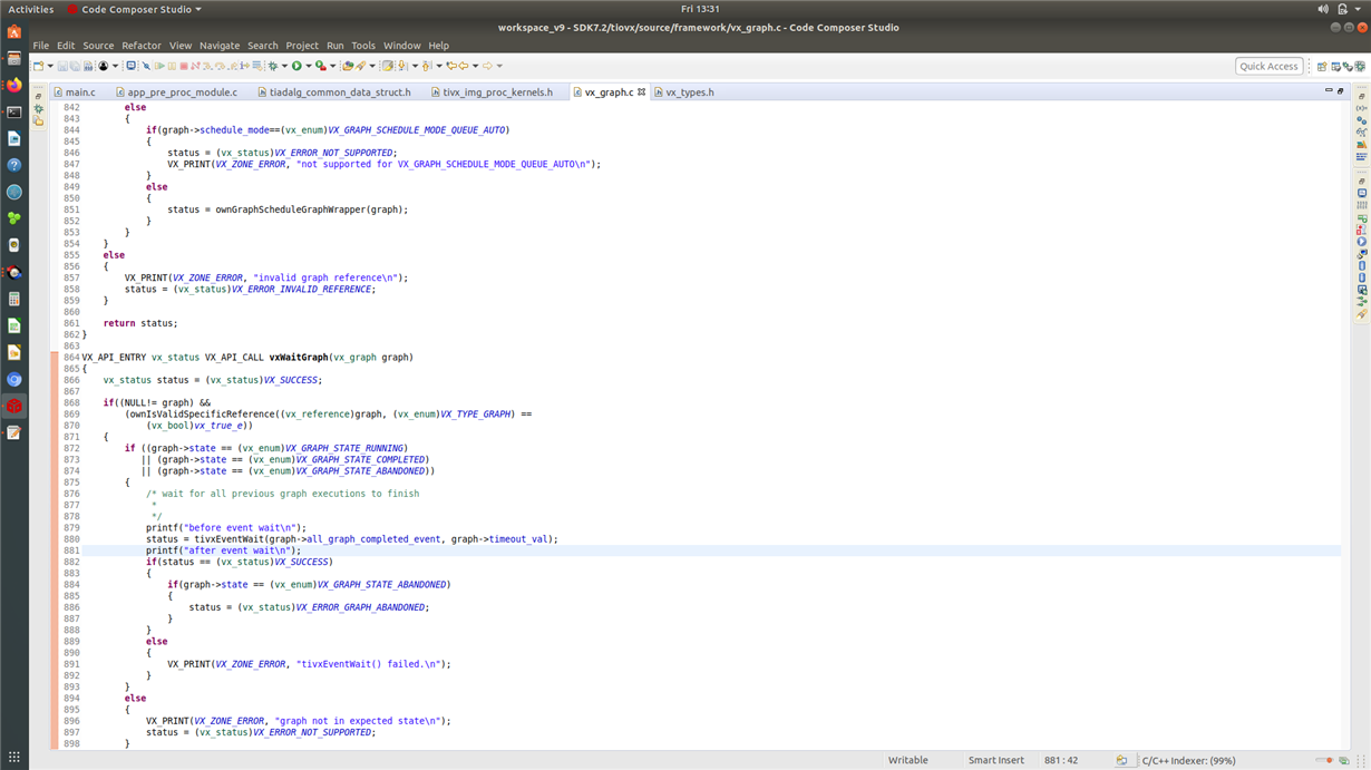

    Regarding the 1st issue posted, Need to add new kernel in appinit.c apptrios. After adding the issue is resolved.
    for 2nd issue, I am using AVP3 demo as reference, our network has Seg, Depth and Detection.
    Seg and Depth is read via pcTIdlconfig and Detection using odTIdlconfig. I am able to use either pcTIDL or odTIDL  not together, can both network share same preprocess node? will it be a issue if I use same preprocess node for both tidl nodes?
    and if run odTIDL alone, task is running for only one frame after that it hangs at tieventwait(), same issue I have faced on SDk7.1 for tidl standalone on EVM, after moving to SDK 7.2 this issue is resolved.
    That time the changes were some thing related to test framework was mentioned for the root cause, is there anything needs to added from test framework to vision apps? same network runs fine on TIDL standalone EVM. with openvx application also it runs fine for single frame.
    However if I run pcTIDL alone, runs fine for all 52 frames.

    App Verify Graph Done!
    App Verify Graph Done! 0
    after schedule graph
    before wait graph
    before event wait
    [C7x_1 ]     44.527225 s:  VX_ZONE_INFO:[tivxTargetNodeDescNodeExecute:601] Node (node=120, pipe=0) acquiring parameters on target 00000080
    [C7x_1 ]     44.527259 s:  VX_ZONE_INFO:[tivxTargetNodeDescNodeExecute:660] Node (node=120, pipe=0) executing on target 00000080
    [C7x_1 ]     44.556227 s:  VX_ZONE_INFO:[tivxTargetNodeDescNodeExecute:683] Node (node=120, pipe=0) executing on target 00000080 ... DONE !!!
    after event wait
    after wait graph
    Processing file
    status = 0
    after one frame
    before wait graph
    before event wait
    [C7x_1 ]     44.618716 s:  VX_ZONE_INFO:[tivxTargetNodeDescNodeExecute:601] Node (node=120, pipe=0) acquiring parameters on target 00000080
    [C7x_1 ]     44.618750 s:  VX_ZONE_INFO:[tivxTargetNodeDescNodeExecute:660] Node (node=120, pipe=0) executing on target 00000080
    [C7x_1 ]     44.648036 s:  VX_ZONE_INFO:[tivxTargetNodeDescNodeExecute:683] Node (node=120, pipe=0) executing on target 00000080 ... DONE !!!
    Please let me know any hint
