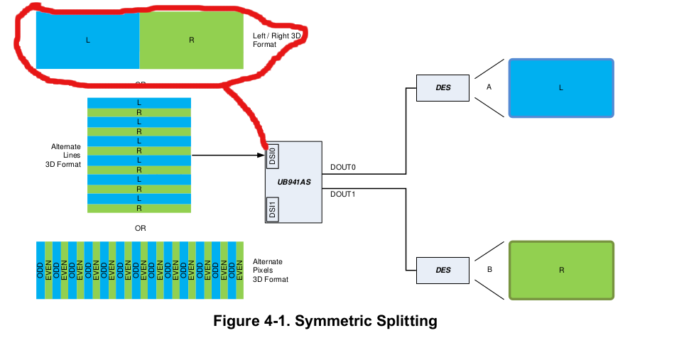

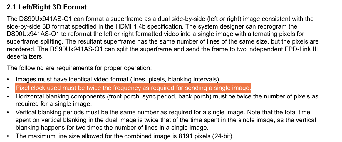

Hi Team, Please confirm us the configuration needs to be done on DSS for having superframe for DS90UB941.
On DSS, we have configured the VP of DSS to have (1920 * 2) × 720 alongwith doubling the values of HFP, HBP, Hsync len. Are we doing it in correct way?
