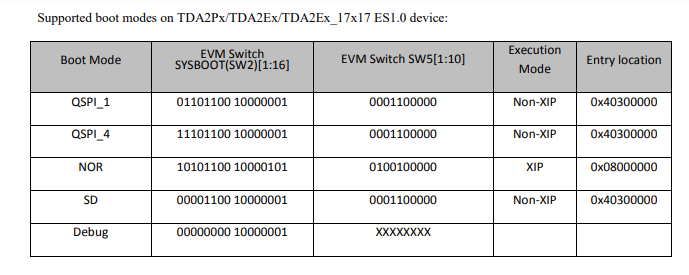

    The boot switch settings for the TDA2Px or (DRA76x) is :
    Gaviraju
    I am talking about the custom board, not the EVM board.
    QSPI boot is not working in the custom board.
    Deepika
