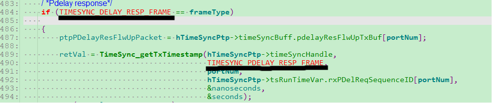

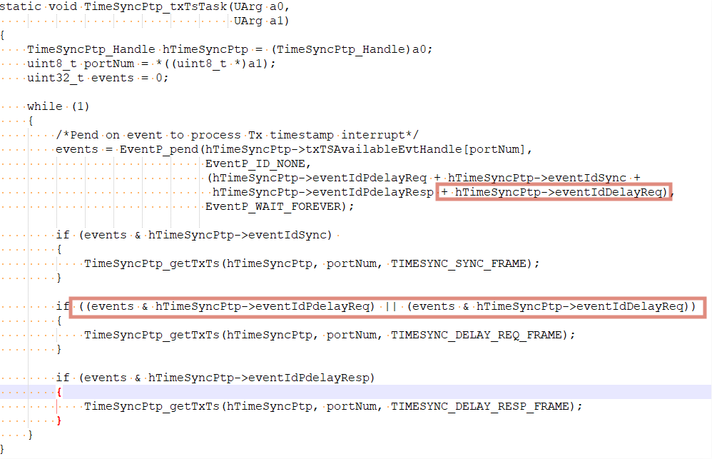

The eventID of frame pending to get Tx timestamp is Pdelay_Requset,while the input para of TimeSyncPtp_getTxTs is TIMESYNC_DELAY_REQ_FRAME.
The eventID of frame pending to get Tx timestamp is Pdelay_Response,while the input para of TimeSyncPtp_getTxTs is TIMESYNC_DELAY_RESP_FRAME.
Another conflict is in TimeSyncPtp_getTxTs() in timeSync_ptp.c
The condition is to check frame type of TIMESYNC_DELAY_RESP_FRAME while get the timestamp of TIMESYNC_PDELAY_RESP_FRAME.
Why?

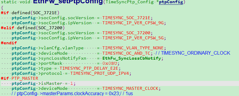

3. Errors happened when getting the time stamp using the mode of E2E over udp.Here is the configuration of Master side:
The error log is:
Is there any other parameters needed to be configured?
    TI : Both Pdelay_Request and Delay Request frames are not handled simultaneously in the timeSync implementation, so internally the timestamp location is re-used. Thus we use the same ID interchangeably sometimes.
    TI: Same logic as above but for delay response. Pdelay_Response and Delay Resp are not handled at the same time. So the internal location and ID's are used inter-changeably
    TI: Same answer as above 2

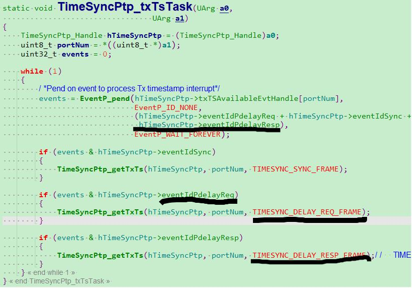

    1. I do not think it is a good way to deal with timestamp re-used. If user wants to get the timestamp of  Delay Request frames, he need to post the event Pdelay_Requset. It is confusing for users.
    Is this a good solution for reusing timestamp and comprehension?

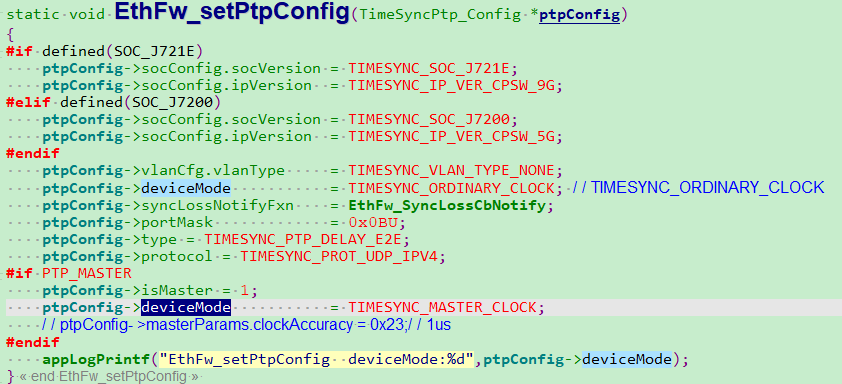

    2. Here is more info about the question 3 (3. Errors happened when getting the time stamp using the mode of E2E over udp.Here is the configuration of Master side) above:
    I tried to perform Time Sync between 2 board over PTP protocol. Main chip of both boards is TDA4 with PDK 7.1.
    Time sync code is :pdk_jacinto_07_01_00_45\packages\ti\transport\timeSync\v2
    One side is configured as Master while another is configured as Slave.
    The parameter is configured as follows using macro as compile option.
    Besides, the static ip address of Master side is 192.168.1.25 while another side is 192.168.1.45.Subnet mask is 255.255.255.0 for both sides.
    Aboves are the information i think important for the configuration. Is thers anything essential for Time Sync?
    Looking forward to your reply,Thanks~
    TI : I agree, as I mentioned previously, for us, E2E + UDP and P2P + L2 were orthogonal use-cases and we never ran into this issue. We will try and incorporate your feedback however.

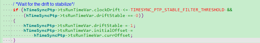

    Furthermore,I tried P2P over 802.3.
    I find something confusing.
    1)
    What if TimeSyncPtp->tsRunTimeVar.clockDrift is greater than TIMESYNC_PTP_STABLE_FILTER_THRESHOLD again after it is less than the threshold ?
    In my debugging,the clockDrift can not maintain stable after it is less than the threshhold,in which condition the value of clockDrift is greater than the threshhold while the flag(driftStable) is also set 1.
    As a result ,the offset value(hTimeSyncPtp->tsRunTimeVar.ltaOffset) can never get less than the  threshhold and stable.
    Do you know any possible reasons?
