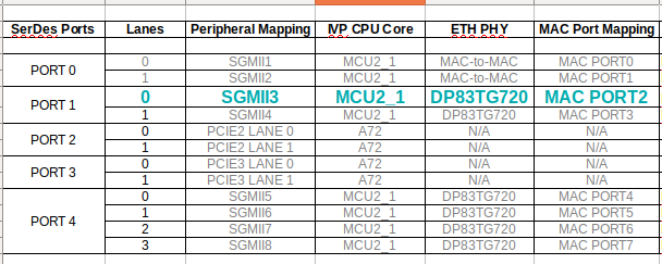

  • Satish Lal Das2 said:
    CpswPhy_enableState: PHY 0: falling back to manual mode
    CpswPhy_enableState: PHY 0: new link caps: FD1000
    CPSW has been stated sucesfully
    This means that the PHY driver was originally requested to use autonegotiation, but BMSR[3] AUTONEG ABILITY is not set - so, by not detecting a auto-negotiation capability on the PHY side, it's falling back to manual mode. Please check if PHY's auto-negotiation is supported and if so, if BMSR[3] is the right bit to check if autonegotiation is supported.

    This is likely a clocking issue. The SGMII registers will be reset to zero if the SERDES clock is not initialized. That is the SERDES must be configured for the SGMII module to be configured.

    On "SERDES clock issue" -
    I am on SDK 7.0 and under "cpsw_appboardutils_j721e_evm.c" I have following function for clock. and this is called from "CpswAppBoardUtils_initEthFw()" & "CpswAppBoardUtils_init()". This implementation shipped with SDK 7.0.
    #if defined(BUILD_MCU2_0)
    static void CpswAppBoardUtils_configSerdesClks()
        uint32_t moduleId, clkId, clkRateHz;
        /* Below is port to SERDES mapping for CPSW9G
         * Port 1 – SERDES0 Lane 0 (Sierra – 2Lane – 16G capable)
         * Port 2 – SERDES0 Lane 1
         * Port 3 – SERDES1 Lane 0 (Sierra – 2Lane – 16G capable)
         * Port 4 – SERDES1 Lane 1
         * Port 5 – SERDES4 Lane 0 Torrent – 4Lane – 10G capable
         * Port 6 – SERDES4 Lane 1
         * Port 7 – SERDES4 Lane 2
         * Port 8 – SERDES4 Lane 3 */
        /* Configure the required PLLs for SERDES0 */
        moduleId  = TISCI_DEV_SERDES_16G0;
        clkId     = TISCI_DEV_SERDES_16G0_CORE_REF1_CLK;
        clkRateHz = 100000000;
        CpswAppUtils_clkRateSet(moduleId, clkId, clkRateHz);

  • For the PHY configuration that doesn't support auto-negotiation - when you open the port link via CPSW_IOCTL_OPEN_PORT_LINK ioctl, please pass the exact speed/duplexity (i.e. CPSW_SPEED_1GBIT, CPSW_DUPLEX_FULL). Passing _AUTO speed/duplex is used as an indication to try to use autonegotiation.
    Which MAC port / SERDES are you having issues with? Let me check your changes and will get back to you.
  • Hi Misael,
    Yes, We have set the fixed speed in PHY Driver. Here is the snippet of the code.
    	/* Set Parameters for Automotive PHYs - Fixed Speed */
    	cfg->isAutomotive = true;
    	cfg->nwayCaps = CPSW_LINK_CAP_FD1000; // 1Gbit/s - Full Duplex
    We are using SerDes 1 - Lane 0 for this testing.
    We have six 720 PHY connected to the following SerDes Lanes. In the file, I sent I enabled all of these Lanes. For debugging & testing, we are enabling one PHY at a time.
    SERDES1 Lane 0
    SERDES1 Lane 1
    SERDES4 Lane 0
    SERDES4 Lane 1
    SERDES4 Lane 2
    SERDES4 Lane 3
    Satish

    I am mainly facing an Integration issue. The engineer who tested this PHY used SerDes 0 -Lane 1 for testing. In our case, SerDes 0 Lane 0 & SerDes 0 Lane 1 is used for MAC-to-MAC connection, and the following SerDes Lanes are connected to 720 PHY's.
    SERDES1 Lane 0
    SERDES1 Lane 1
    SERDES4 Lane 0
    SERDES4 Lane 1
    SERDES4 Lane 2
    SERDES4 Lane 3
    For the testing, I have just enabled SerDes 1 Lane 0 ( CPSW_MAC_PORT_2) in main_tirtos.c and that's where I started getting this error.

    SerDes Lanes is still a mystery to me. I changed the Lane number to 2 & 3 (instead of 0 & 1) and enabled only lane 2 in CSL_serdesIPSelect() for SerDes 1. However, I revert the Lane number from 2 & 3 to 0 & 1 and tested with only Lane 0.
    The result was - No matter what lane number I keep i.e.  0 or 2 I still get the same logs. I would have expected one of them not to work. Not sure what I am missing here but do you agree that one of those tests should fail?
    I am using SDK 7.0 , could you please let me know what Lane number I should use for Following SerDes Instance  -
    SERDES0 Lane 0  - ?
    SERDES0 Lane 1  - ?
    SERDES1 Lane 0 - ?
    SERDES1 Lane 1 - ?
    SERDES4 Lane 0 - ?
    SERDES4 Lane 1 - ?
    SERDES4 Lane 2 - ?
    SERDES4 Lane 3  - ?
    Thank you again for your help.
    Satish

    Anyway, the correct values to pass are:
    • SERDES0 Lane 0  - serdesInstance=CSL_SIERRA_SERDES0, serdeslaneNum=0
    • SERDES0 Lane 1  - serdesInstance=CSL_SIERRA_SERDES0, serdeslaneNum=1
    • SERDES1 Lane 0 - serdesInstance=CSL_SIERRA_SERDES1, serdeslaneNum=2
    • SERDES1 Lane 1 - serdesInstance=CSL_SIERRA_SERDES1, serdeslaneNum=3
    • SERDES4 Lane 0 - serdesInstance=CSL_TORRENT_SERDES0, serdeslaneNum=0
    • SERDES4 Lane 1 - serdesInstance=CSL_TORRENT_SERDES0, serdeslaneNum=1
    • SERDES4 Lane 2 - serdesInstance=CSL_TORRENT_SERDES0, serdeslaneNum=2
    • SERDES4 Lane 3  - serdesInstance=CSL_TORRENT_SERDES0, serdeslaneNum=3
    In all cases, pass phyType=CSL_SERDES_PHY_TYPE_SGMII, phyInstanceNum=0.

    Opening this thread again. I started testing each PHY one by one by assigning the Lane number as suggested. These are the Lanes mapped to 720 PHY. I can see that the first two Lane works. However, Lanes from SerDes4 is not working. I don't even see any logs.
    • SERDES1 Lane 0 - serdesInstance=CSL_SIERRA_SERDES1, serdeslaneNum=2               - WORKS
    • SERDES1 Lane 1 - serdesInstance=CSL_SIERRA_SERDES1, serdeslaneNum=3               - WORKS
    • SERDES4 Lane 0 - serdesInstance=CSL_TORRENT_SERDES0, serdeslaneNum=0           - DOESN'T WORK
    • SERDES4 Lane 1 - serdesInstance=CSL_TORRENT_SERDES0, serdeslaneNum=1           - NOT TESTED
    • SERDES4 Lane 2 - serdesInstance=CSL_TORRENT_SERDES0, serdeslaneNum=2           - NOT TESTED
    • SERDES4 Lane 3  - serdesInstance=CSL_TORRENT_SERDES0, serdeslaneNum=3          - NOT TESTED
    I don't see any logs from ethernet firmware when Enable SerDes4 Lane 0. These are the changes I made.

  • serdesLane4EnableParams.baseAddr          = CSL_SERDES_16G1_BASE;"
    Does this looks correct to you for SerDes Instance 4? In some places in code, I found it should be 10G0 ?
  • Hi Misa,
    I changed "serdesLane4EnableParams.baseAddr          = CSL_SERDES_16G1_BASE;"" to  serdesLane4EnableParams.baseAddr          = CSL_SERDES_10G0_BASE;" for SerDes4 and it let me progress to validate next two Lanes in SerDes4. Now the result looks like below -
    • SERDES4 Lane 0 - serdesInstance=CSL_TORRENT_SERDES0, serdeslaneNum=0           WORKS
    • SERDES4 Lane 1 - serdesInstance=CSL_TORRENT_SERDES0, serdeslaneNum=1           - WORKS
    • SERDES4 Lane 2 - serdesInstance=CSL_TORRENT_SERDES0, serdeslaneNum=2           - DOESN'T WORK

  • Satish,
    Correct, CSL_SERDES_10G0_BASE is the baseaddress for CSL_TORRENT_SERDES0.
    Try with numLanes = 4 and laneMask = 0xF.
    Also try having all CSL_serdesIPSelect() calls for all 4 lanes regardless of the port you have enabled in gEthAppPorts.

    Using numLanes = 4 and laneMask = 0xF. , I passed that error now.  However, there is something weird is happening.
    Usually when PHY-Driver bind happns I noticed 'OK" message in front of "dp83tg720". In this case "OK" message is coming from a "generic" driver. and then
    several "GenericPhy_isResetComplete: PHY 10: reset is notcomplete" messages.
    CpswPhy_bindDriver: PHY 10: OUI:367e36 Model:1f Ver:08 <-> 'dp83tg720'
    CpswPhy_bindDriver: PHY 10: OUI:367e36 Model:1f Ver:08 <-> 'generic' : OK
    Do you know what could be the issue here?
