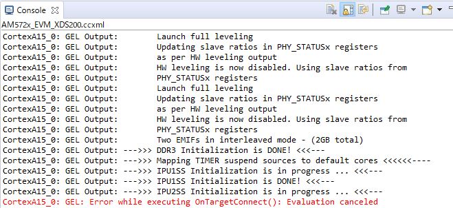

When I connect to the target with CCS, it stops at the following initialization.
CortexA15_0: GEL Output: --->>> IPU2SS Initialization is in progress ... <<<---
Do you know why the initialization here stops?
My environment:
HW : AM572x EVM, XDS200(Spectrum digital)
SW : CCSv10.1, processor_sdk_rtos_am57xx_6_03_00_106
Sasaki
    Please refer to the GEL scripts under ~/ccs/ccs_base/emulation/boards/am572x/gel/AM572x_multicore_reset.gel.
    You can add some more trace via GEL_TextOut() to see where it stuck in the script.
    The function is IPUSSClkEnable() in AM572x_multicore_reset.gel.
    Please make sure the EVM doesn't have any binary running when you try to connect it in CCS.
    Stanley
