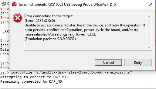

    These 3 scripts are likely of use in debugging the issue:
    http://git.ti.com/sitara-dss-files/am335x-dss-files/blobs/raw/main/am335x-ctt.dss
    http://git.ti.com/sitara-dss-files/am335x-dss-files/blobs/raw/main/am335x-ddr-analysis.dss
    http://git.ti.com/sitara-dss-files/am335x-dss-files/blobs/raw/main/am335x-ds0-analysis.dss

  • Hi
    The error does not occur each time. I can enter and leave standby mode more than 100 times before the error occurs. I have made a test case in which I enter every five seconds in standby, keep it for 2 seconds and exit standby mode. And this for hours and hours. Often it occurs after more than 10 hours.

    But I have another question. I tried to execute the ddr script (am335x-ddr-analysis.dss). But I run in the following problem (also with reduced TCLK). The other script am335x-ctt.dss works.
    Thanks & Best regards
  • Sorry, here is the picture from the script/JTAG error (am335x-ddr-analysis.dss)

  • Brad Griffis said:
    Hopefully you noticed and are not attempting to use the AM57xx script.
    I downloaded the correct one. But it's still not working. I tried a TCLK from 10kHz until 10MHz.
  • I don't think the TCLK is actually related to the issue in this case given that you mentioned the other scripts were working fine.
    Can you try running this command from the Linux console prior to using the script:
    devmem2 0x44e00414 w 0x52580002
    Does that fix things?  One other option is to change line 104.  Currently it is:
    debugSessionDAP = ds.openSession("*","CS_DAP_M3");
    You could instead change it to:
    debugSessionDAP = ds.openSession("*","CS_DAP_DebugSS");
    I won't go into all the details of why the script is written this way.  In short, there are a lot of conflicting uses of the script, and it's hard to make it work for all of them!  Hopefully one of these two suggestions does the trick.
    Brad
    Hi Brad,
    I'm very sorry. Both of your mentioned solutions did not work.
    I could reproduce the error now. So I could read back the ctt. The file is attached. Can I do something more?
