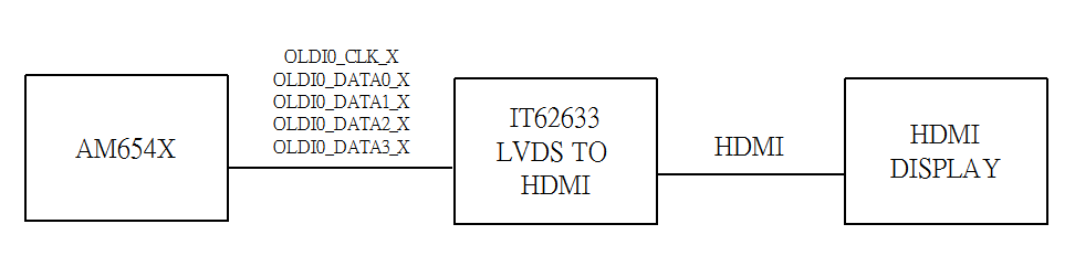

Dear TI
We want to use the am65x(linux sdk) to connect to the hdmi screen
Because GPMC has been used, We use the OLDI interface to connect to IT62633 for html screen output
The device tree I configured is as follows
But It can’t find any devices when I use the modetest command
How to configure the device tree for following ???
Thanks~
device tree:

modetest
root@am65xx-evm:~# modetest

no device found
root@am65xx-evm:~# ^C
