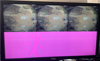

    I use run_app_multi_cam.sh, I can get capture  a frame
    but display not clear, I want  to know  this error  Segmentation fault

    Could you please share your multi-cam usecase code?
    I will try to add support for LDC in it, then you could test it out.
    Rgds,
    Brijesh
  • 5417.app_multi_cam.tar.gziss.tar.gzmodules.tar.gzsensor_drv.tar.gz
    I use  ti-processor-sdk-rtos-j721e-evm-07_02_00_06  src code,
  • it seems zip file is not correct, Could you please zip again and share app_multi_cam folder?
    Rgds,
    Brijesh
    Since your sensor outputs in YUV format, can you please make sure that
    - obj->enable_viss flag is set to 0x0
    - obj->sensorObj.enable_ldc flag is set to 0x1 for YUV422 to YUV420 conversion
    - obj->enable_mosaic flag set to 1 to enable mosaic dispay.
    This should give mosaic display for multiple camera.
    Brijesh
  • Hi
    thank you very much this problem is resolved

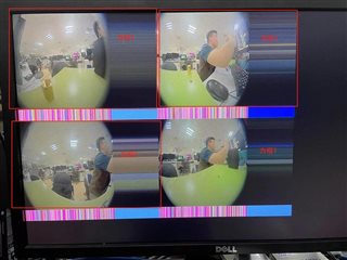

  • Hi
    my camera format  resolution ratio 1280x960,  red  circle is 640x480, I want to display 方框1  content  data,  how to change code display  4  lane camera
    My:  log:

    Sorry, did not get your question, what do you mean by "I want to display 方框1  content  data,  how to change code display  4  lane camera"?
    It seems from the image, all 4 camera are able to capture, but not full image. Do you mean why they are not able to capture full image?
    Brijesh
  • HI
    yes,I want to konw  why they are not able to capture full image?
    thanks
    can you please save one capture output and see if this is coming from capture?
    I remember you were getting complete frame few days back. So wondering if frame is getting cropped due to addition of LDC.
    Brijesh
  • thank you very much, I solved this issue
