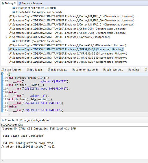

We are trying to load the IPU2 binary where the EVE application is embedded in that using CCS and JTAG.

Hello Gaviraju,
We are implementing the below requirement, standalone i.e non vision sdk
1. Hello World EVE Program
2. Hello World IPU Program
3. Convert EVE binary into Header using TI tools and embed into IPU code
4. Build IPU Program
5. Load IPU binary (EVE embedded ) in CCS, IPU 1 core using JTAG
6. Result - EVE and IPU Hello world prints on the console
The aim of our task to load EVE via IPU core (i.e EVE embedded) and test on CCS using JTAG
We have used eve loader file for all the SBL call from IPU core to load EVE during runtime.
Note: we have used only SBL api's, all the sysbios and system_start call were commented to check only EVE loading functionality.
We are able to progress till step 4,however on loading IPU core and debugging till SBLLibRegisterImageCopyCallback(), we receive positive response "EVE loaded successfully", but we aren't able to debug the EVE part of the code.
Please do let us know if we are missing any steps in order to execute EVE binary after it is being loaded by IPU.

Can you put a while loop in the EVE code then connect a Debugger to EVE core then start debugging.
Ex:
volatile int debug = 0xffff;
while(debug);
Add these line of code in the beginning of the EVE code & it will be waited here until you set the variable "debug = 0"

The support of EVE firmware loading from IPU is added only when the Linux boots on A15 core, seems you are not booting Linux on A15 core, Are you booting Linux on a15?

Hello Gaviraju,
Eventually Yes, we will be using A15+Linux in our solution.
But as of now, we have developed a standalone application of IPU to test the EVE loading. Currently, we only have spectrum digital xds510usb JTAG debugger, hence we have not used A15+Linux, instead IPU+EVE only.
