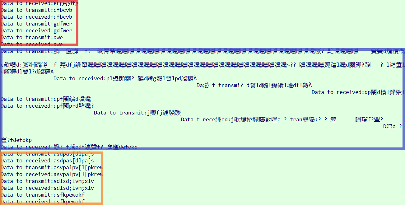

Hi Expert
When baud rate is 460.8K bps, uart output is abnormal.
When device temperature is high the output is abnormal, but device temperature is low the output is correct.
Could you give me some suggestion to debug this issue?

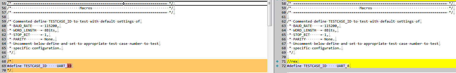

I don't think UART would behavior differently with temperature.
Unless the die temperature goes beyond 123C, the device would shut down and reboot.
Could you share the change where you modify the baud rate for 460.8K?
I don't think our UART driver by default supports 460.8K in SDK.
Do you see any problem with baud rate set at 115.2 kbps?
