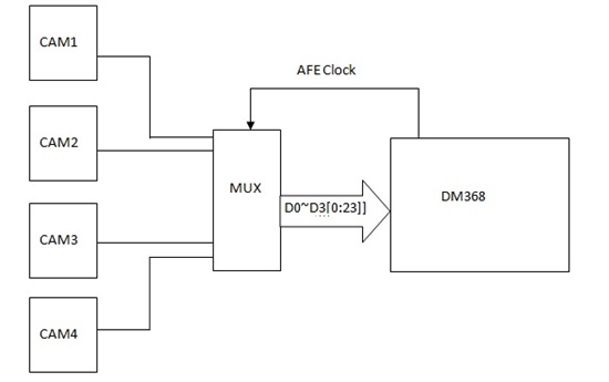

  • Data are output in an array of each block such as Ch1-Ch2-Ch3-Ch4-Ch1-Ch2-Ch3-Ch4-Ch1.....interleaved at 30Mhz /channel and 120 Mhz total for all channels. Do you think I can use the 16-Bit Parallel AFE directly getting data that way without glue logic FPGA?
    After processing each D1 image in frame based, then need to send 4 separated D1 images out locally. Since DM368 only has one 16bit digital output Bus, we have to interleave 4 D1 images again to output the data to FPGA/CPLD that splits data into 4 D1 images, then output NTSC video encoder. So, it seems that we cannot do the split without the FPGA or CPLD in output but may can do in the input, if AFE can support 120MHz input, is this possible? Thanks.

  • Hi, Steve,
       IF I want to try the idea to use 120 MHz AFE to get data in, what is the master  clock in DM368 should be?
    JIm
  • Jim,
    What are the clock sources for your AFE? What AFE are you actually using?
    Basically, if you are a camera sensor that can receive a clock then the DM will need to source the clock. If the input is from a video decoder, video ADC etc... then the clock will need to come from that.
    Can you put a quick block diagram together to show me exactly what you are trying to do please?
    BR,
    Steve
  • Steve, above is the diagram I am using.
  • Does each CAM provide its own clock or does it expect to receive the clock from the processor?
    Is the MUX intended to merge all 4 cameras into a single video stream or simply to select one camera at a time?
    BR,
    Steve
  • CAM expected external clock. MUX will form a single c1-c2-c3-c4-c1-c2-c3-c4-.. streaming. Jim
  • jim,
    At what level is the multiplexing done? Pixel, pixel-pair, line, frame, other?
    The method most likely to work would be at the frame-level building a super-frame composed of 2x2 frame images. It would require the AFE being able to handle the total resolution, and there could be camera-boundary issues with filtering, but those might be solvable in an FPGA. What I am picturing is not at all a trivial multiplexer, but it could work.
    I am a bit confused about what you want on the output, too. Are you looking for analog component video to 4 TVs or (analog) composite video to 4 TVs? Do you want to demux 4 digital channels from a DSP to go to 4 encoders or a single interleaved digital stream to a demuxing encoder?
    Sorry for the questions. It looks like there has been a while since your last post, so maybe you have closed this. Please let us know either way.
    RandyP
