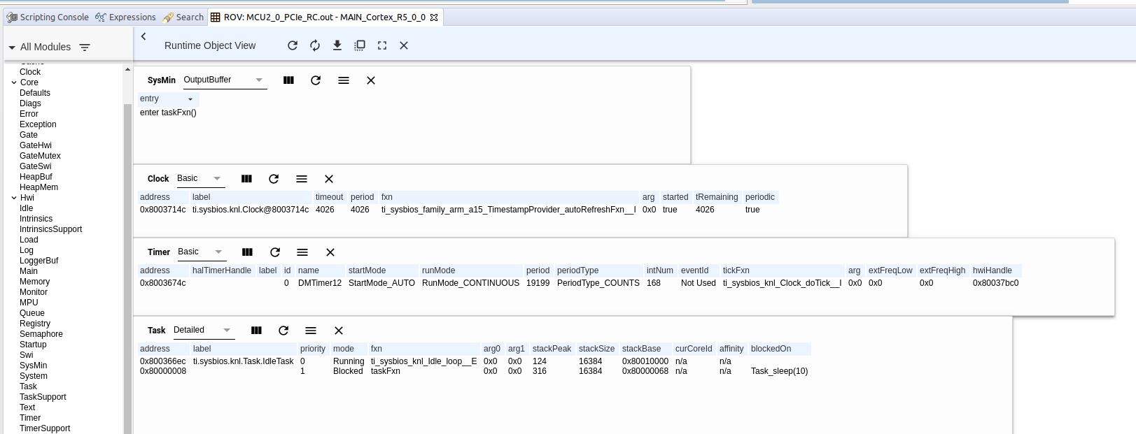

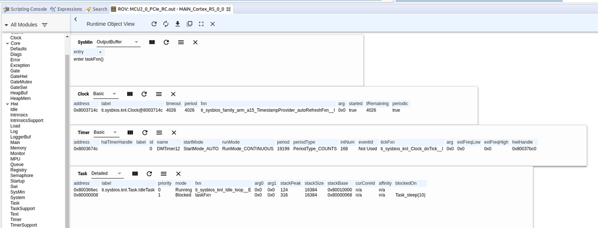

I have a TDA4EVM here which runs linux (psdk-linux-j7-evm-07_02_00_07), and a SysBios application for MCU2_0. Linux and SysBios should run in parallel.
I boot the board with Linux, then connect CCS via jtag emulator to the MCU2_0 (without any GEL instructions) stop the core, load and start my SysBios app.
It runs fine, until it hits the first Task_sleep instruction. From this point, it never returns and spins only in the Idle function. I suspect maybe a problem with the timer, could you please give me a hint what I should check next? And how?

  • This is a screenshot from the ROV view regarding Clock and Timer, I don't know if this helps to diagnose:
    Values from Clock/Timer does not change after the application hit the first Task_sleep. However, I'm not sure if they should at this point.
    Thank you very much and best regards,
    Thomas
