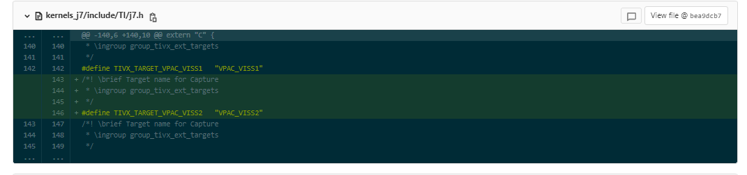

According to the above test, I think it is the tiovxAddTargetKernelVpacViss() function in the tiovx/kernels_j7/hwa/vpac_viss/vx_vpac_viss_target.c file, only one VPAC_VISS1 is registered. So I added VPAC_VISS2 to tiovx and modified it as follows.
1. Add the definition of TIVX_TARGET_VPAC_VISS2 in the kernels/include/TI/j7.h file

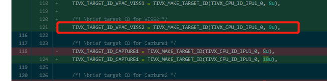

2. Add target_id in the source/platform/psdk_j7/common/tivx_platform_psdk_j7.h file

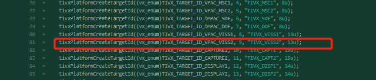

3. Register TIVX_TARGET_VPAC_VISS2 in the source/platform/psdk_j7/bios/tivx_target_config_mcu2_0.c file

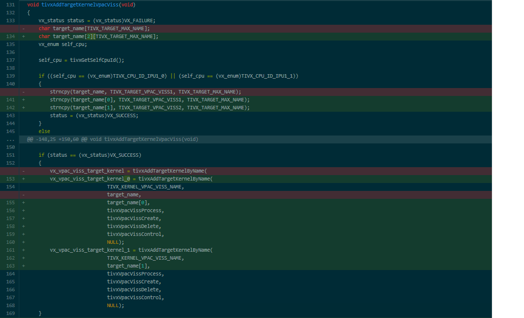

4. In the tivxAddTargetKernelVpacViss() function of the kernels_j7/hwa/vpac_viss/vx_vpac_viss_target.c file, make the following modifications.

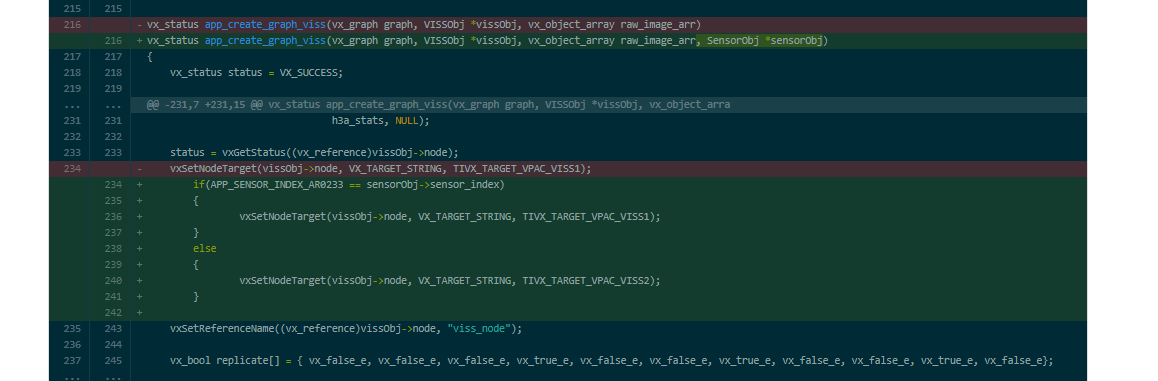

5. In the app_multi_cam application, use TIVX_TARGET_VPAC_VISS1 and TIVX_TARGET_VPAC_VISS2 according to sensor_idx, and modify as follows:
