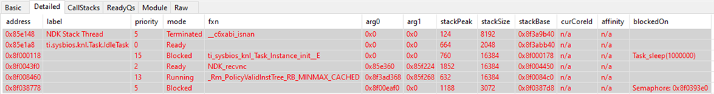

    4. In the ROV view, there should be several tasks. Is the http server task called "daemon", from the stackSize and stackPeak, do you see any issue? E.g, stack overflow? Besides the daemon and idle, do you have any other NDK threads running? Or have any other tasks with priority higher than the daemon?
    5. You mentioned "CONNECTION_REFUSED" error, which NDK file listed this error code? I don't see this in the latest NDK.

    4. ROV does not show any stack overflow as visible in the next picture
      /resized-image/__size/640x480/__key/communityserver-discussions-components-files/791/pastedimage1617804919866v1.png
    5. Connection refused is what we see from client. No CGI file is sending that. I think it might be because the DSP actively refuses the failing request with the FIN ACK packet immediately after client send the request.

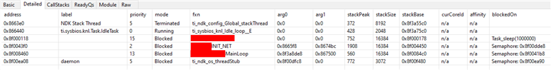

    ROV status after the restart tentative is exactly how shown in this screenshot:
    As this is very critical for us, can we arrange a call to have a look at the code and live debug?

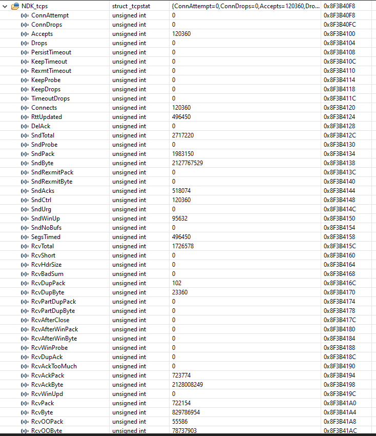

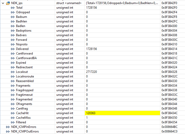

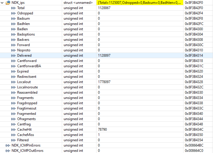

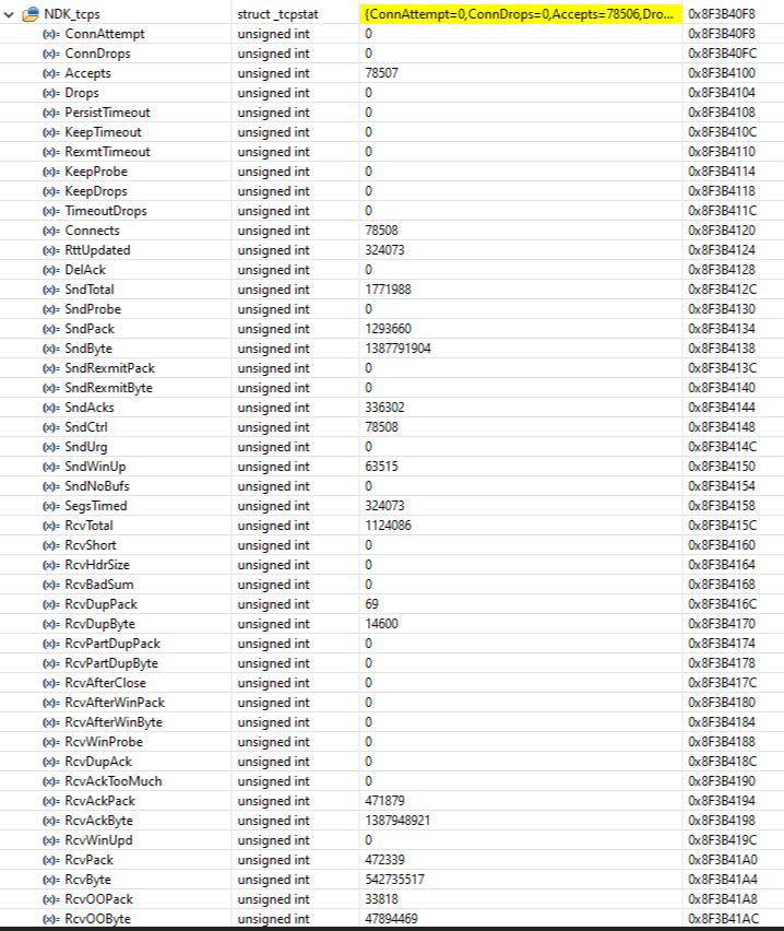

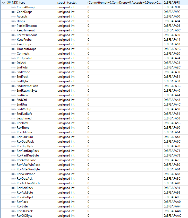

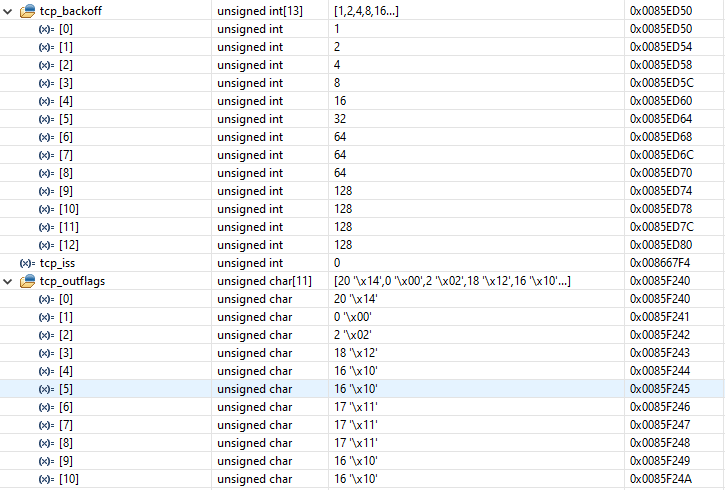

  • I am able to replicate the issue in about 1h and 20 mins when sending requests every 30/40 ms. You can maybe try that?
    This does not seem to be an issue related to mine, I have actually the feeling that these might be more similar:
    https://e2e.ti.com/support/legacy_forums/embedded/tirtos/f/ti-rtos-forum-read-only-archived/490959/tm4c1294-ndk-emac-hangs/1776221#1776221
    https://e2e.ti.com/support/microcontrollers/other/f/other-microcontrollers-forum/710149/rtos-tm4c1290ncpdt-ndk-in-ti-rtos-works-intermittently-after-being-shutdown-and-restarted
    https://e2e.ti.com/support/legacy_forums/embedded/tirtos/f/ti-rtos-forum-read-only-archived/146989/omapl138-c6748-ndk-emac-potential-driver-bug
    https://e2e.ti.com/support/legacy_forums/embedded/tirtos/f/ti-rtos-forum-read-only-archived/514100/ndk-stops-responding-on-ethernet
    https://e2e.ti.com/support/legacy_forums/embedded/tirtos/f/ti-rtos-forum-read-only-archived/223029/ndk-stops-responding#pifragment-322104=2
    Does this give you any more suggestions?
    Another thing we have noticed is:

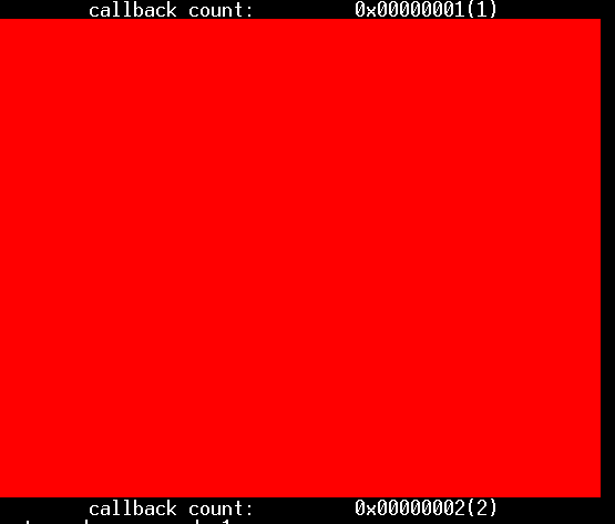

    I have verified this and I can confirm that the NIMU_testNetworkOpen is called a second time after net NC_NetStop(1)
    Have a look at the flag printed here (I have censored non relevant data):
    callback count:         0x00000001(1)
    callback count:         0x00000002(2)
    I believe that there is something going wrong in the middle because if I try to restart the net again this variable is not incremented again.
    The callback completes two times fully. Maybe one of the other callbacks fail. I will investigate further

    I have done another change: I have increased the stack size of the dchild thask. This is a task that is spawned by NDK to serve the HTTP requests.
    With this change, the test that was only 1h and 30 minutes long is now running for 2h and 30 minutes and still going.
    I have also started another test that usually was averagely 4h long and will update on the result.
    If any of these tests stops I will run again the send.exe tests to check the result I get from it.
    Still, how can this not being visible in ROV?
    How could we check how this stack is influencing my test execution?
    Thank you
    BR, Fabrizio

    Regarding the flags you are asking: I have checked the names and it is correctly NDK_tcps, yet the values are all 0s. the only tcp-like global variables I have seen that are not 0s are the following (taken after system crash):
    just for reference, here also the NDK_tcps variable:
    This also should respond to the link you have sent: HTTP crashed (we do not know why yet) TCP was accepted but then DSP not pingable anymore.

    I was able to get the NDK stats we were talking about, but I do not see any difference between healthy and unhealthy system:
    tcps healthy
    tcp unhealthy
    ips healthy
    ips unhealthy
    tcp send winapp works after the crash happens and I can also see the NDK_tcps stats increase in that case.
    It seems that the HTTP layer is the one that crashes after receiving a certain number of connections and it does not come up after using TCP connection successfully.
    When sending HTTP requests I see no change in the NDK_tcps.
