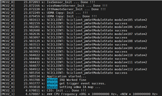

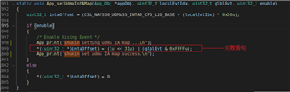

  • when i use app_gpio_dma.c ,During operation, there is an exception.
          This file is integrated into the vision_app basic_demos/app_tirtos, app_gpio_dma.c the file is only added in a few places to print, no other changes

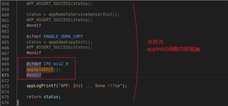

    The timing of the call
                     [common/appinit.c] appInit() call appGpioInit()
    log positioning failed to run to the write L2G register
          log output

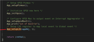

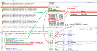

    To use CCS debugging, I moved the functions in the app_gpio_dma.c regarding gpio interrupt configuration and UDMA interrupt routing configuration to the pdk/drv/udma/example/udma_sw_trigger,. The following functions were used to configure the interrupt
    The compile (CORE=mcu2_0) runs (normal before adding changes) and is located in the same place where an exception occurs when L2G register is written
    Time to call
    app_create() end, add call
          I adjust the timing of the call elsewhere in the app_create(), and the exception is still located in the same place.

    /* Setup GPIO Pinmux */
    App_setupPinmux();
    /* Initialize GPIO now here */
    App_initGpio();
    /* Configure GPIO Mux to output event on Interrupt Aggregrator */
    App_setupGpioMuxIr();
    /* Setup L2G register to map local event to Global event */
    App_setupL2G(appObj, 1);
