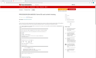

I tried to create a SD card with create-sdcard.sh but I didn't manage to have a proper one without manually copying two files to FAT32 partition. I have now a working SD card but I'd like to have a properly working shell script too. The procedures are mentioned in the files

. The first one contains an error "zImage: No such file or directory" and the second one " file not found" without the filename. Only MLO and u-boot.img were in the FAT32 partition but no zImage and dtb file.

  • Hi Jani,
    Which version of the Processor SDK do you use?
    Please share the full log of your create sdcard process.
  • Hi Bin,
    Can't you see the two attachments? I thought in the first place that these answer to your questions.  I can see them as in this new picture.
    Jani
  • Hi Jani,
    In the first log, the answer for the question below should be '1' instead. Kernel image and device tree file should be in the rootfs, so you don't have to specify them in this step.
       For Kernel Image and Device Trees files
        What would you like to do?
         1) Reuse kernel image and device tree files found in the selected rootfs.
         2) Provide a directory that contains the kernel image and device tree files
            to be used.
    Choose option 1 or 2 : 2
  • Thanks, Bin,
