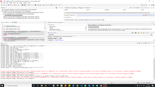

On AMIC110 evaluation kit, we are trying LED/GPIO example program and while debugging/flashing using Code composer studio, we find memory verification error, screenshot attached.
Any suggestion on how to have it resolved? Thanks.

    Yes, XDS110 should also work according to the guide. I checked your CCS configuration file and it looks fine. It seems to me that you ware able to launch the target in CCS and connect to A8 core. Did you have problems when loading the .out file or running it? Can you provide some more detailed information on what you did and share a screen capture when the problem happened?
    Jianzhong
  • Hi Jianzhong,
    Yes, we could build, launch/connect to target/A8 core, after adding the out file means loading this error was identified, please see the screenshot as follows:
    Thanks & Regards
    Satyabrata Mohanty

  • Hi Satya,
    Thanks for sharing the .out file. I tried it on my AMIC110 ICE EVM and it worked fine. So looks like your board may have some problems. You may want to double check CCS data verification error debugging. I missed this link in my previous post.
