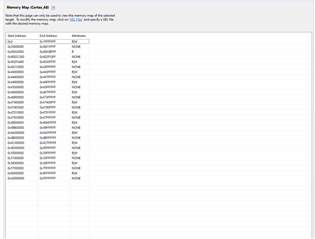

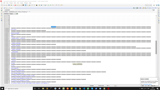

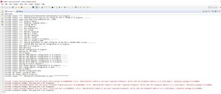

TMDXICE110: Data Verification Error
Part Number: TMDXICE110
Other Parts Discussed in Thread: AMIC110
We're using TMDXICE110 board, ti-processor-sdk-rtos-am335x-evm-06.03.00.106 and xds110 debugger for the development purpose. When trying to load any DDR based application (consider UART_BasicExample_iceAMIC110_armExampleProject for reference),  it's throwing data verification error. Following is the error image.
We tried  debugging / resolving the issue based on this reference. When Diagnosing RAM Problems, we found that all the contents of DDR memory is zero. Following is the image.
As per the link, this behavior is observed when memory is non-existent, but the board contains DDR3. Is the DDR3 got damaged or any wrongdoing? How to check whether DDR is working or not ?
Note:
1. Able to load and run hello world application successfully which will be located in internal memory
2. Following is the gel file

3. Following is the memory map
4. Gel file initialization is happening during connect and is successful. Following is the output
CortxA8: Output: **** AMIC110_ICE & BoosterPack Initialization is in progress ..........
CortxA8: Output: **** AMIC110 & Booster Pack ALL PLL Config for OPP == OPP100 is in progress .........
CortxA8: Output: Input Clock Read from SYSBOOT[15:14]: 25MHz
CortxA8: Output: **** Going to Bypass...
CortxA8: Output: **** Bypassed, changing values...
CortxA8: Output: **** Locking ARM PLL
CortxA8: Output: **** Core Bypassed
CortxA8: Output: **** Now locking Core...
CortxA8: Output: **** Core locked
CortxA8: Output: **** DDR DPLL Bypassed
CortxA8: Output: **** DDR DPLL Locked
CortxA8: Output: **** PER DPLL Bypassed
CortxA8: Output: **** PER DPLL Locked
CortxA8: Output: **** DISP PLL Config is in progress ..........
CortxA8: Output: **** DISP PLL Config is DONE ..........
CortxA8: Output: **** AMIC110 BoosterPack ALL ADPLL Config for 25 MHz OPP == OPP100 25MHz is Done .........
CortxA8: Output: **** AMIC110 DDR3 EMIF and PHY configuration is in progress...
CortxA8: Output: EMIF PRCM is in progress .......
CortxA8: Output: EMIF PRCM Done
CortxA8: Output: DDR PHY Configuration in progress
CortxA8: Output: Waiting for VTP Ready .......
CortxA8: Output: VTP is Ready!
CortxA8: Output: DDR PHY CMD0 Register configuration is in progress .......
CortxA8: Output: DDR PHY CMD1 Register configuration is in progress .......
CortxA8: Output: DDR PHY CMD2 Register configuration is in progress .......
CortxA8: Output: DDR PHY DATA0 Register configuration is in progress .......
CortxA8: Output: DDR PHY DATA1 Register configuration is in progress .......
CortxA8: Output: Setting IO control registers.......
CortxA8: Output: EMIF Timing register configuration is in progress .......
CortxA8: Output: EMIF Timing register configuration is done .......
CortxA8: Output: PHY is READY!!
CortxA8: Output: DDR PHY Configuration done
CortxA8: GEL Output: Turning on EDMA...
CortxA8: GEL Output: EDMA is turned on...
CortxA8: Output: **** AMIC110_ICE Initialization is Done ******************
