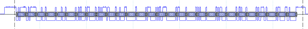

The first strange behavior regards the transmission. Sometime, roughly  1 over 1000, the frame sent out by our AM33354 microprocessor is not correct. There is one byte unexpectedly inserted in the first position, then we get the normal frame except the last byte that is missing.
The byte prefixed is always the first byte of the previous transmitted frame (frame which is correct).
For example:
 the following frame has a wrong prefixed 0xFA
The correct frame would have been:
FA 10 00 10 00 0A 03 EA 03 84 00 00 07 E5 00 03 00 05 00 0D 00 0D 00 39 00 83 02 9C
Thus, the length is correct, but from the real frame the actual one is truncated by 1 byte and 1 byte is inserted in the first position.
The previous frame was :
Which starts with 0xFA too. If this previous file started by 0xYY, then the worn one would start by 0xYY.

The problem we are experiencing is that many opcode 20 requests (like 1 in 70) fail because the first read() instantly returns a block of data filled with a single repeated value.
We analyzed the RS485 line with an oscilloscope, and concluded that this data is not present on the bus.
