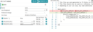

  • Hi Keerthy,
     We are using I2C5 as an interface between the clock chip and J7.
    When I ran - "i2c bus" it showed me the following output. I noted that "Bus 8:  i2c@2050000" is the right bus for i2c5. and that's why I started probing Bus 8.
    I am using SDK 7.0 and in my SDK I don't see any i2c8 as well. i2c6 is the last node mapped in "k3-j721e-main.dtsi".

  • Hi Keerthy,
    I apologize for replying late here.
    Based on my Device tree setting I already have i2c5 added in k3-j721e-common-proc-board.dts. This is the code I have
    +       /* Pointing to IVP HW */
    +       i2c5_avb_clk_pins_default: i2c5_avb_clk_pins_default {
                    pinctrl-single,pins = <
    -                       J721E_IOPAD(0x1a4, PIN_OUTPUT, 3) /* (W26) RGMII6_RXC.AUDIO_EXT_REFCLK2 */
    +                       J721E_IOPAD(0x260, PIN_INPUT_PULLUP, 4) /* (T28) MMC2_DAT3.I2C5_SCL */
    +                       J721E_IOPAD(0x264, PIN_INPUT_PULLUP, 4) /* (T29) MMC2_DAT2.I2C5_SDA */

    I also checked Ball T28 & T29 is not used anywhere in my device tree except in I2C5.
    Satish
  • Hi Satish,
    I2C5_SCL & I2C5_SDA also come out on Y26 & AA27 respectively. Just one last check from my side on the pinmuxing angle.
    - Keerthy
  • Hi Keerthy,

  • About Y26 & AA27 - I audited my device tree changes and don't see these ball numbers anywhere in my device tree.
    These are the DT changes I have
    diff --git a/arch/arm64/boot/dts/ti/k3-j721e-common-proc-board.dts b/arch/arm64/boot/dts/ti/k3-j721e-common-proc-board.dts
    index d1a2eb4153b0..a5a5430fdac5 100644
    --- a/arch/arm64/boot/dts/ti/k3-j721e-common-proc-board.dts
    +++ b/arch/arm64/boot/dts/ti/k3-j721e-common-proc-board.dts

     &main_i2c1 {
            pinctrl-names = "default";
    -       pinctrl-0 = <&main_i2c1_pins_default>;
    +       pinctrl-0 = <&i2c1_msp_pins_default>;

     &main_i2c3 {
    @@ -728,44 +911,36 @@
    -&mcasp10 {
    -       #sound-dai-cells = <0>;
    +&main_i2c2 {
    -       pinctrl-0 = <&mcasp10_pins_default>;
    +       pinctrl-0 = <&i2c2_slot7_5_pins_default>;
    +       clock-frequency = <400000>;

  • Satish,
    Not sure about your custom board but for J721e TI board:
    This is coming out on AA27 & Y26 pins.
    So my DT is like:
    I do not see anything on i2cdetect -f 8 like yours.
    Even i2c probe in u-boot has nothing to show as there is nothing on it.
    - Keerthy
  • Hi Keerthy,
    In our case AA27 & Y26 is mapped to "MCAN0_STB" & "MCASP2_FP_AXR4". I compared the pinmuxing of J7 EVM and on our board, those pins are purposed differently on both boards.
    This is how our pinmuxing looks like
    I think you are not seeing the device from uboot because there is no device. In my case I do have a clock chip on I2C5 which is visible from uboot but not from Linux. Is there any way I can add some logs somewhere  in linux or check any register from CCS to debug this?
    Satish
  • Hi Satish,
    Dump the pinmux registers associated with I2C5 on your board in both u-boot & Linux & check if they are same.
    Also you may want to read this w.r.t i2cdetect:
    https://raspberrypi.stackexchange.com/questions/102026/why-i2cdetect-slave-can-not-detect-polling-way-but-interrupt-can
    Keerthy
  • Hi Keerthy,
    We can close this thread. It works now.
    Satish
  • Hi Satish,
    May i know what change? It will help me understand.
    Keerthy
  • Hi Keerthy,
    There was no code change made from my side. I observed this issue in SDK 7.0 & 7.1 however I was testing SDK 7.3 yesterday and it works in this SDK.
