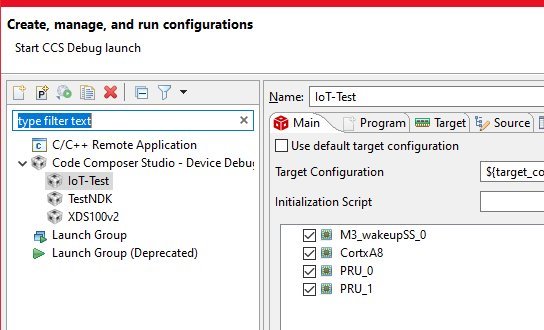

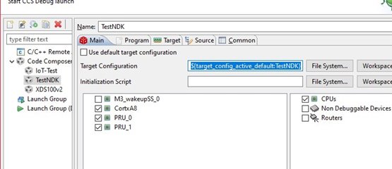

If I instead select Debug Configurations, I get a different screen. Let's look at it, as I have three projects open.
Pick one: TestNDK
That project has a ccxml in the root named "TestNDK-xds.ccxml" Well the dialog shows me ${target_config_active_default:TestNDK}.
Close, but not a match... where does it get these values? I can find nothing in the project properties | Debug section, or anywhere else, that maps ${target_config_active_default:TestNDK} to the TestNDK-xds.ccxml

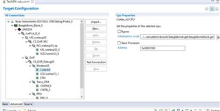

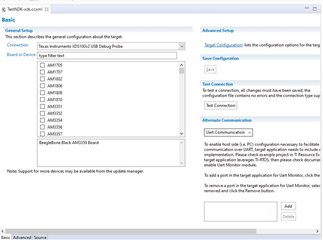

When I open the ccxml file, I get a completely different page. Absolutely nothing in common.
I can see it allows me to pick the MCU. And the advanced setting has a bunch of settings that I can find no help on.
I see the BBB/A8 setting has a GEL file, but the path is relative. TO WHAT? Apparently something NOT related to the project.I had to hunt it down... And it's 1000's of line that look like C code and contain stuff that I see in Starterware header files.
I also read years ago that the environment was moving away from GEL files. Of course trying to find that old doc page would be nearly impossible.
If I change the MCU, the GEL file is erased. Where does it get the GEL files, and what happens if there isn't one? Do I have to make one by hand?
Lets now look at the project IoT-Test...
This is a mess, nothing matches.
The debug dialog has all four cores checked.
Of course, it claims the ccxml file is part of the project. ${target_config_active_default:IoT-Test} But I have no idea what name it THINKS it is supposed to be.
The ACTUAL file located in the targetConfigs folder is named BeagleBone_Black.ccxml. Which is the one under the dialog as XDS100v2 (the name of the JTAG device connected to it).
Where in the project IoT-Test does it know to use that ccxml file?

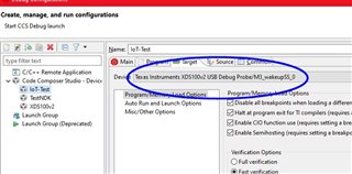

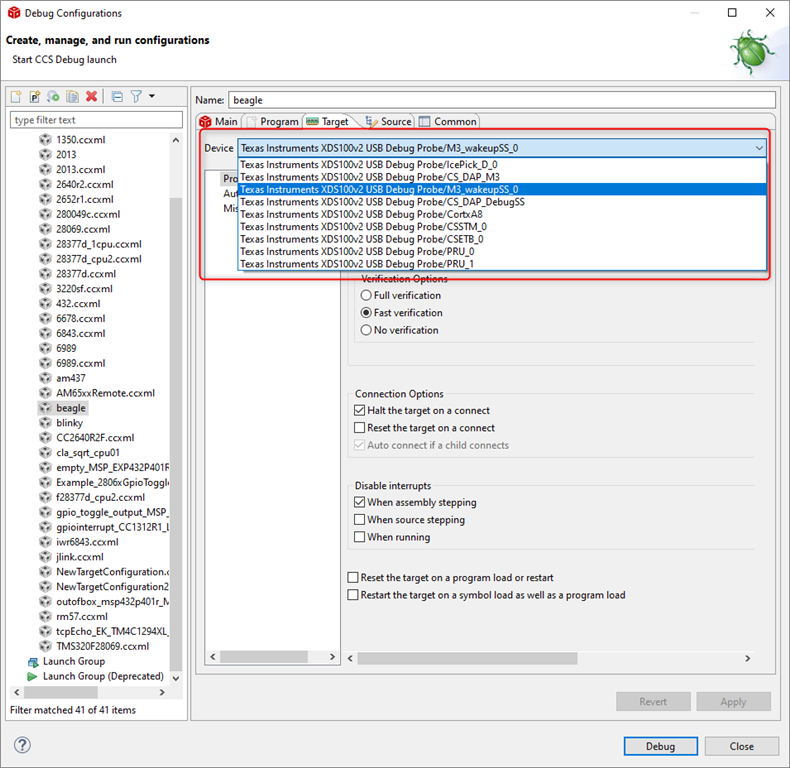

It gets worse.
If I click Target tab, it says the device is IcePick... Unless I click a different...? What? (That window on the left has no name.)
I click TestND... then click back to IoT-Test... when I click back it's set to M3_wakeupSS_0
Neither of which is correct.
So, this setting is wrong. And yet the environment magically knows what settings I want to use when debugging this project. Based on some environment variable that doesn't exist.
