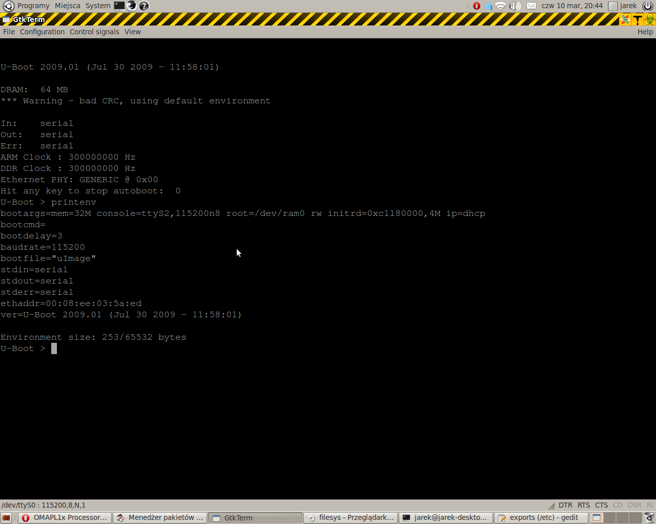

I am new to dsp programming in particular omapl-l138.  went through QSG and read a lot of articles on the OMAP-l138 from e2e.ti and processors.wiki.ti .In QSG  there is written that the U-Boot bootloader, Linux kernel, and file system are burned to flash memory (SPI1) during manufacture. There is also written that if I set properly S7[5:8] dipswitches and connect board with my PC using null-modem serial cable, after pressing reset button i should see u-boot command line in my terminal emulator and if I don't push any other button, after 3 seconds should start booting linux kernel.  I did everything like was written in QSG, but after 3 seconds after u-boot command line(I not press any button) linux kernel won't start. What em i doing wrong? Here is printscreen of my terminal emulator;
  • It looks like your boot images got corrupted. You should go through and reflash the UBL and UBOOT on the SPI flash according to the instructions on the wiki.
    The best solution for you would be to download the SDK4.0 software package. This includes handy scripts which will automate the process of getting Linux booted.
    Jeff
  • Thanks for reply.
    I reflash SPI flash and for now everything work.
  • Now i have another problem. I try boot linux using nfs. I have installed DVSDK 4 and setup nfs using  script witch i find in bin directory of DVSDK 4 root directory. It seems that nfs works fine - server starts without errors(only when i try to re-start server, i need to use sudo privileges, otherwise server fail to starts ), but when linux is booting in console appear error like this;

    I see that there is trouble with nfs mounting, but now i have no idea how resolve this problem.
    Any suggestions?
  • I sloved my problem. I have bad bootargs. I rewrite them from UserGuide, where they look like this; setenv
