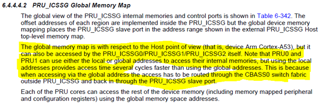

In ICSSG1, customer wants to read some data from ICSSG0’s shared memory.
Does it can do that? And how?
According to the forum about AM47x, I think AM65 can also do it.
https://e2e.ti.com/support/processors/f/processors-forum/659580/compiler-processor-sdk-am437x-sharing-variables-across-pru-s?tisearch=e2e-sitesearch&keymatch=pru0%25252525252525252520access%25252525252525252520pru1
By using the below code.
customer cannot get any value from g_pFarPRU0.
volatile int *g_pFarPRU0 = (int *)(0x0B010000);  // pointer to PRU0 shared memory
Any comments?
