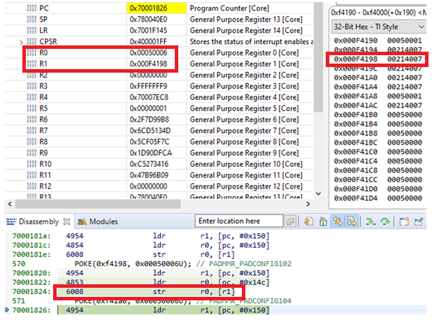

I would like to change PinMux register setting in CCS (v10.2.0.00009) by hand in Memory Browser window after application start on a custom board.
PADMMR_LOCKx_KICKx registers are 0. And I can not overwrite any pin mux register. Why? There was no such limitation on AM65xx IDK.
Even I had no success with such code:
POKE(0xf1008, 0x68EF3490U); // PADMMR_LOCK0_KICK0
POKE(0xf100c, 0xD172BC5AU); // PADMMR_LOCK0_KICK1
POKE(0xf4274, 0x00050002);  // PADMMR_PADCONFIG157
I would like to test some settings before introduce them "officially" by sysconfig tool and rebuilding of PDK.

  • Hi James,
    this code piece is running on an R5_0_0 core of AM6442.
    I do not think on RAT, because I see pinmux registers at the expected addresses in the memory browser.
    See the lockregisters, LSB of PADMMR_LOCK0_KICK0 register @ 0xf1008 is set.
    And see no result of store operation
    Can the Board_init function prevent any further manipulation of pinmux registers?
    regards
    Kalman

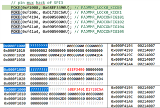

  • Kalman,
    Once the PAD configuration registers are unlocked (via writes to PADMMR_LOCK0_KICK0/1 & PADMMR_LOCK1_KICK0/1), you should be to write the PAD configuration registers in the associated partition.
    The EVM GEL scripts contain a hotmenu script which unlocks the PAD configuration MMRs. In CCS: Scripts->Lock-Unlock->CTRL_Unlock_All.
    The PAD configuration registers can be unlocked by Board_init() using the BOARD_INIT_UNLOCK_MMR bit-mask argument.
    Have you experimented with these?
    Frank

  • Hi Kalman,
    Is this still an issue for you? I'm unable to reproduce this problem on an AM64x EVM.
    After launch.js completes, I load R5F_0_0 with a test application which calls Board_init() with BOARD_INIT_UNLOCK_MMR.
    This is an excerpt from the first part of Board_init()
    Board_STATUS Board_init(Board_initCfg cfg)
        Board_STATUS ret = BOARD_SOK;
        ret = Board_sysInit();
        if (ret != BOARD_SOK)
            return ret;
        if (cfg & BOARD_INIT_UNLOCK_MMR)
            ret = Board_unlockMMR();
            return ret;
    This is a screen capture of CCS just before Board_unlockMMR() is called:
    This is a screen capture of CCS after Board_unlockMMR() is called:
    Frank
  • Hello Frank,
    thanks for info.
    I got success with CCS unlock script recently.
    Kalman
