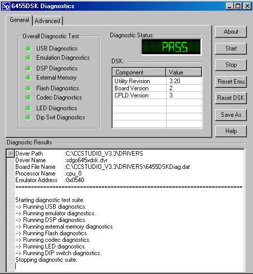

I have two board: DSK6455 (without connector J9 for mezzanine card) and EVM6455 with mezzanine card (J9 connector).
With DSK6455 I use DSK6455 Diagnostic Utility v3.3: this program tests all devices in DSK and all tests are ok.
After I use EVM6455 (but mezzanine card is disconnected!) and DSK6455 Diagnostic Utility v3.3 fails in test of codec AIC23.

  • Stefano,
    Stefano said:
    1) it's right this? the DSK6455 Diagnostic Utility v3.3 works only in DSK and not in EVM? Someone can try this in EVM6455 (with mezzanine disconnected)? or maybe the codec in my EVM is damaged.
    This is not right. I am pretty sure that the main board of the EVM is the same as the DSK other than the mezzanine connector. It sounds like the codec or some wiring is damaged. Have you tried any program examples that would use the codec to see if you can get anything to work with it?
    Randy, yes, I tried with TI' project dsk_app (example in C:\CCStudio_v3.3\boards\dsk6455_v2\examples\dsk_app) and, in EVM, DSP is stopped in routine DSK6455_AIC23_rset at line DSK6455_I2C_write (I2C line doesn't works...):
    void DSK6455_AIC23_rset(DSK6455_AIC23_CodecHandle hCodec, Uint16 regnum, Uint16 regval)
        Uint16 buf = ( ( regval & 0x00FF ) << 8 ) | ( regnum << 1 ) | ( regval >> 8 );
        DSK6455_I2C_write( DSK6455_AIC23_I2CADDR, ( Uint8* )&buf, 2 );
        if ( regnum < DSK6455_AIC23_NUMREGS )
            codecstate.regs[regnum] = regval;
    With DSK it's ok.

  • Stefano,
    Your description sounds pretty clear that there is a board or device problem on your EVM base board.
