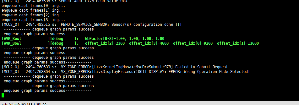

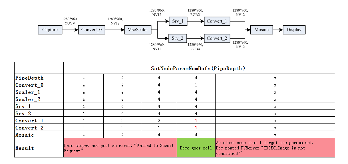

Hi there:
  The picture above shows my srv graph.And the background is that there was two Display Nodes after Convert_1 & Convert_2. All of the params above was setted to 4. It goes well and the video shown on screen was normal too.
    Then I tried to use Mosaic Node to merge images from those two Convert Nodes instead of two Display Nodes. So I tried lots of test by modifying different parameter settings and finally found a set of suitable parameters.
    But I'm confused and I wander:
     ①Why do I must set NumBufs of Convert_1 & Convert_2 to 1 can make it work ?
     ②What factors should be considered when setting the parameters or the parameter setting depends on what conditions?
    Hopeing I have described the problem clearly !
    Looking forward to replying !

  • Thank you Lucas,
    I just set the output of Capture as graph parameters. And I did some modifications in the Capture node to fit our camera(1280*960 YUYV output). But I don't think think it has anythung to do with my problem. Cuz the demo always goes well before I have added Mosaic.
    As for the document you mentioned, my colleagues and I gave read it many times. Didn't find any clue about the solution to this problem.

  • Hi, Brijesh:
    Thank you for caring about this issue !
    I can't deny your guess, although I've checked the code over and over again. However, given that the test of the last set of parameters ( by setting Convert_1 & Convert_2 to 1) makes the it run successfully. I think the parameters might be right.
    In addition, add a piece of information: when I set the value of NumBufs of Convert_1&Convert_2 to be bigger than 1. The program has done 4 times Enqueue&Dequeue loops before it stopped. And there are static Video shown on the screen (as showned  below). It seems that the data flow is blocked or the buffer between some nodes is not enough to use ?
    It might be a bit excessive if I ask you to please reproduce my situation, but I've been stuck with this problem for a long time and stiil haven't found any clues.

    Could you provide the source for the app_create_graph_convert and the app_create_graph_img_mosaic?  I am trying to review the parameter setting for each of these.  I think you can attach a zip file to this E2E if that makes it easier to share.
    Lucas

    I am not seeing the below in the source code that you provided.  Could you please either point me to it or include this as well?
    obj->convertObj_2.arr_Replicate
    obj->convertObj_3.arr_Replicate
    Lucas
    Actually, I didn't set Convert_2 & Convert_3 to replicate.  In combination with 'Init Graph' and 'Convert Init', you can see this logic. And the reason is the image of the four channels has been combined for one channel after Srv node. So I don't think the Replicate operation is needed in all those nodes after SRV. I'm I right ?
    Yes, you are correct.  I did not notice that there was a check inside the app_create_graph_convert to only replicate if 1 channel was being used.
    Do you also have the source of the app_create_graph_srv?  I presume this is creating an object array of a single image and using that output to create the SRV node, but I wanted to check.
    Given that this use case is very large, it is a bit tricky to determine what issues could be occurring.  So that I can better understand your questions, are you getting the expected SoC performance and are curious about why the parameter requires only one buffer, or are you not getting the expected performance and therefore trying to increase this number of buffers?
    Lucas
    As mentioned in my first question, there are two points I'm currently concerned about. And I'm not pursuing high performance yet. It seems this demo can only run normally when I set NumBufs of Convert_2 & 3 to be one.
    I'm using four cameras as input of this graph. I created an object array of four images to be  the input of SRV node.
    Thank you very much for following up my questions so responsibly ! And I think it will become easier and more accurate and clear If I can send the source code to you. May I ?

  • Hi Damon,
    I had to change one other thing in the app to get it to build.  I changed the APP_REMOTE_SERVICE_SENSOR_CMD_CONFIG_UB960 to APP_REMOTE_SERVICE_SENSOR_CMD_CONFIG_IMX390 since APP_REMOTE_SERVICE_SENSOR_CMD_CONFIG_UB960 was not defined.  However, when I run, the app appears to hang, perhaps because of this change.
    Are there any additional changes beyond what you have sent that I need in order to run the app?
    Also, if you have been able to reproduce this in a smaller app, that would be helpful given that this is app is fairly large and will be difficult to debug.
    Lucas
  • Hello Lucas,
    Since  the camera I'm using is different from yours, I added an additional macro: APP_REMOTE_SERVICE_SENSOR_CMD_CONFIG_UB960.
    But my issue seems to have nothing to do with the camera node. I just made another test in which I used LDC node instead of Camera + Convert ndoe, and use pictures to simulate. The same error still there when I set the Num of params of Mosaic node to greater than 1.
    There is a macro named USE_CAPTURE_NODE which determines whether to use camera or LDC in app_srv_camera.c. How about you try to set it to be 0 and see if it will print the same error as mine ?
  • Hello Damon,
    I have set this to 0 and the app runs.  However, it looks like it needs some test files at /opt/vision_apps/test_data/input/.  Could you please provide these?
    Lucas
  • 8713.input.zip
    Hi Lucas,
    Sorry for my carelessness. Here are the test files.
    Damon
  • Hello Damon,
    Sorry for the delays here and thank you for your patience.
    I was able to duplicate your issue on my end.  The issue here ultimately has to do with how the object array items are supported with pipelining.  There is a limitation with using these "composite objects" with our pipelining implementation.  However, there is a workaround that can be used in this case to enable multiple buffers at the given parameter.
    The workaround in this case is to enable vxReplicateNode for the convertObj_2 and convertObj_3 even though there will be only a single instance of this node.  Therefore, in the app_convert_module.c, you can comment out the line "if (1 < convertObj->numCh)" that checks for multiple channels and instead call the vxReplicateNode regardless of the channels enabled.
    In addition, you will need to set the below parameters in the convertObj_2 and convertObj_3 structures:
            obj->convertObj_2.arr_Replicate[0] = vx_false_e;
            obj->convertObj_2.arr_Replicate[1] = vx_true_e;
            obj->convertObj_3.arr_Replicate[0] = vx_false_e;
            obj->convertObj_3.arr_Replicate[1] = vx_true_e;
    With these changes above, you should be able to set the number of buffers to the desired value.
    Please let me know if you are able to duplicate this setup.
