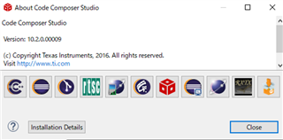

I'm facing the trouble that the behavior is different between on board (TDA4VM EVM) and on Host Emulation.
Please refer to the below for more details and could you share the schedule of the fix and temporary WA please.

The CHAR64 type pointer is incremented 128 times, and the loop count number is compared with assert to see if it is correct.
■Results
When the evidence is executed, the following results are obtained
TDA4VM-EVM
can be executed normally
Host emulator on PC
assertion occurs and stops abnormally

    Some basic concepts:
    i) When you're using host emulation on your PC (x86), you're using a native compiler (say g++ in Linux) and you're linking to the host emulation library "libC7100-host-emulation.a" (for Linux). In this case C++ has no notion of vector data types natively, and the host emulation library implements these vector data types as classes.
    ii) When you're building for EVM (Target), you're now using TI's compiler (cl7x) for c7x which natively supports these vector data types.
    Coming to your code, I see that you're creating 2 vector pointers to scalar data, but when you try to do the comparison: ptr < ptr_limit
    For the case of host emulation, you're comparing two objects (which is incorrect for what you're trying to do). Refer to SPRUIG6E (Section 5.8) for list of valid operations on vector pointers which will work for both host emulation and target.
    It works on EVM because as mentioned in ii), you're using cl7x which natively supports uchar64 as a data type, and pointer behavior is similar to scalar data types in C++.
    Let me know if you have any more questions.

  • HaTa,
    The section describes all the supported operations for vector pointers. If not mentioned, it means its not supported.
    In fact the document mentions this in the same section as well, the older releases too, but in the latest public release (1.4.2) you'd see this :
    "No other operators are supported, including using the array (subscript) access operator ([index]). Using the array access operator may result in a segmentation fault, as an internal data structure that implements vectors and vector types might be used after its memory is freed."
