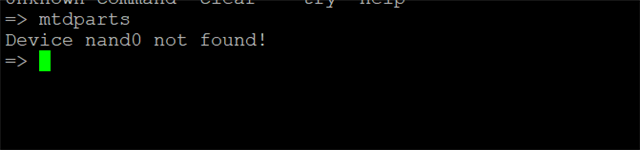

    Generally speaking, u-boot and kernel/fs could boot from different boot media as required by design.
    I think you've verified booting u-boot from SPI, and kernel/fs from SD card...
    Also, can we go for QSPI NOR flash(64Mbytes) which is already available on the EVM?
    1. boot from SD card
    2. run "mtdparts" @u-boot prompt. it is expected that QSPI mtd partitions would be listed which should matches "@qspi node" defined
    in the u-boot board DT file "u-boot/arch/arm/dts/keystone-k2g-evm.dts" as listed below:
    3. follow instruction to flash u-boot etc... to QSPI
    software-dl.ti.com/.../Foundational_Components_U-Boot.html
    4. continue boot kernel/fs (from SD card), and follow instruction to flash kernel/fs to QSPI mtd partitions
    software-dl.ti.com/.../QSPI.html

  • Hi Hong,
    I'm not able to get nor partition when i'm running mtdparts command after MLO. Can you please help me to get mtd partitions  after MLO just like the example you have sent before. Please find attachment.
    Vishnu

  • Hi Hong,
    Yes I'm able to flash onto QSPI but that is after booting with SD card. As the partition I'm getting is after complete boot with SD card.
    But After MLO there's no such partition then how it will get to know the partiton and How could it able to launch the kernel and mount the rootfs which I've flash onto QSPI?
    Note:-
    Because After MLO we need to set the path of kernel/rootfs, etc. as an environmental variable.
    In my case I've flashed onto QSPI MTDPARTS (After complete boot with SD card)  but After MLO there are no   MTDPARTS. So as an environmental variable what i need to set to specify the path of kernel/rootfs/devicetree  which is resides onto QSPI(MTDPARTS)?
    I think if we're getting mtdparts for QSPI just after MLO (As mentioned in one of your replies) would make easier the whole process.

  • => sf erase 0x009C0000 0x3640000
    SF: 56885248 bytes @ 0x9c0000 Erased: OK
    => fatload mmc 0 ${loadaddr} arago-tiny-image-k2g-evm.ubi
    12320768 bytes read in 605 ms (19.4 MiB/s)
    => sf write ${loadaddr} 0x009C0000 0xBC0000
    device 0 offset 0x9c0000, size 0xbc0000
    SF: 12320768 bytes @ 0x9c0000 Written: OK
    Hi Hong,
    Please also note this is how i'm loading  "arago-tiny-image-k2g-evm.ubi" to QSPI partition.
