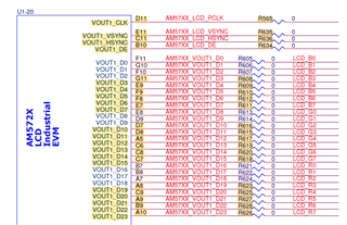

For HW change,
in their custom LCD board, they are using RGB565 mode and connected as below.
D11 : LCD_CLK, E11 : LCD_VSYNC, C11 : LCD_HSYNC, B10 : LCD_DE,
G11, E9, F9, F8, E7, D7, D8, A5, C6, C8, C7, A8, C9, A9, B9, A10 : LCD_DATA(RGB565)

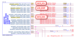

E14 : GPIO, connected to DISP of LCD to control LCD.
AG3 : GPIO, connected to Touch Interrupt
E6 : ehrpwm2A, PWM LCD Backlight
There is touch IC connected through I2C, and I2C5 was used for it.
And their device tree for LCD and PWM is as below.
