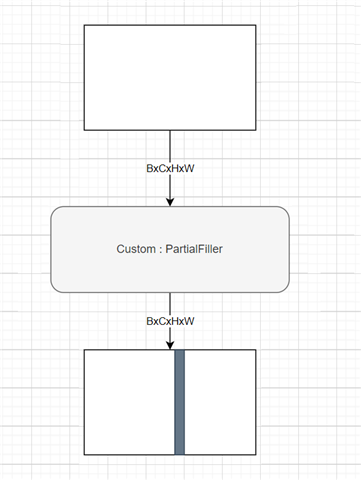

I have to implement a custom layer which changes only small part(boundary or center) of input.
I'd like to reuse input buffer to avoid useless IO.
Could guide how to implement such custom layer?

         Do input and output dimension changes with the processing which you are doing? Or they are expected to remain the same.
    Anshu
  • Hi Anshu,
    Input and output must be same. Custom layer fills very small part of input by zero.(padding clear)
    Wilson

    I already tried "doesLayerChangePadding=0". It didn't work.
    What I want is that one buffer is used for input/output of custom layer. In Vision SDK, it was called "in-place queue mode".
    Wilson.

    I have attached the figure for explaining how the custom layer works.
    The PartialFiller layer set specific areas of input to zero for making input of next layer.
    Can you explain why layer 3 is not overlapped?
    I think if the in/out of the partialfiller layer is overlapped, it just update specific areas and it can avoid useless I/O as well.
    Regards.
    Dongwon Choi
