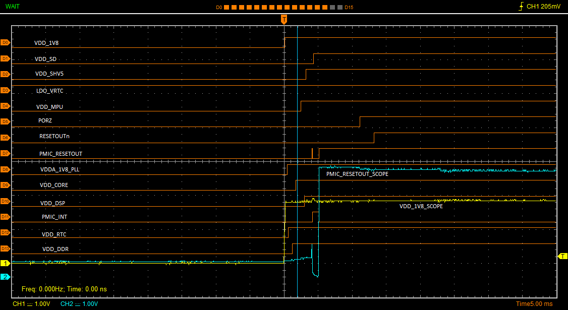

    We have two revision of custom designed boards.
    We are using USB1 for msc device.
    We have a problem in R0 with VDDA_USB2 tied to GND so to resolve that bug created a revision and connected VDDA_USB2 to VDDA_USB1 which is connected to 1.8V PHY as shown in Beagleboard-X15 schematics.
    R0 works with GEL file from ccs directory on above defined changes and completes HW levelling of DDR RAM.
    while R1 fails with ERROR: HW-Leveling time-out for same GEL file while creating comparison for PRCM_Get_Config from GEL files below are the changes observed.
