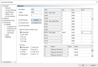

when using Twincat with the IDK I can look at the ESC memory @ status register 0x110
these bits are bits reported by PRU ? how do I tell how each of theses bits are set @ PRU code ? I have a weird issue in which although I can talk with the sitara device at a custom board, I see physical link bits are both false (and only one phy seems to connect the device to twincat)

  • Thanks for your answer.
    I was able to get the expected value from 0x110 after following your advice.
