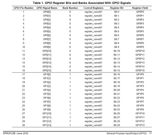

  • Each GPIO set contains 16 pins.  However since the OMAP-L138 is a 32-bit architecture, GPIO0 and GPIO1 combined make up BANK0, GPIO2 and GPIO3 are BANK1, etc.

  • Christina,
    Then I must be totally mis-interpreting the following table from the GPIO User Guide (sprufl8b, page 12). Can you explain further?
  • The "BANK" register name is probably causing the confusion.  In the header file, the "BANK" register refers to the register_name under the Control Register column, not the Bank column.  From the table, you'll see that both GPIO0 and GPIO1 uses register_name01, which is BANK[0] in the header file.
    --Christina
  • Christina,
    Wow, that's unfortunate. EVERYWHERE else in the GPIO document "Bank" refers to the...ummm..... Bank.
    I'm afraid I give up on the PSP and CSLR due to documentation deficiencies.....

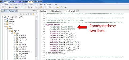

    I was stuck on the same problem last year and I noticed a struct declaration error into the file "cslr_gpio.h" that belongs to the rCSL package 2.0. Look that:
    If you comment these lines the address the DIR and OUT_Data regs get the right position in the memory bank. REVID and BINTEN regs are already defined into the "CSL_GpioRegs" struct.
    I hope this information can be helpful to the future rCSL users.
