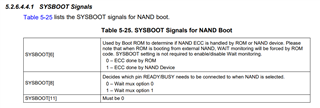

  • Some additional information from the TRM:
    Can you check if you have SYSBOOT[6] cleared to enable ECC by ROM?
  • I have made a mistake. The NAND is an Micron MT29F1G08ABADAH4.
    here is an link to the micron device page:
    MT29F1G08ABADAH4 (micron.com)
    I have no account to download the datasheet but I have an offline copy. How can I provide the offline copy to you?
    Furthermore I'm aware that the device status is obsolete. For our product, we have replaced this NAND by another vendor part. But we have many devices delivered to our customers where this Micron NAND is a part of.
    You are right, this is a problem in our design. The SYSBOOT[6] is not cleared. it has a pull-up resistor and this could cause addtional problems for our device if the fist block of the NAND, which holds the SBL, is corrupted.
    But nevertheless this should only effect the ROM bootloader if I understand the manual correctly, the SYSBOOT option is only used within the ROM bootloader code. Correct?
    Or does this option also effect the SBL behavior?
  • Thanks for the link. I briefly looked at the data sheet and it actually has internal ECC. But anyway, if NAND doesn't do ECC, ROM ECC should be enabled, i.e. clearing SYSBOOT[6].
    This is correct. SBL is not affected by SYSBOOT.
