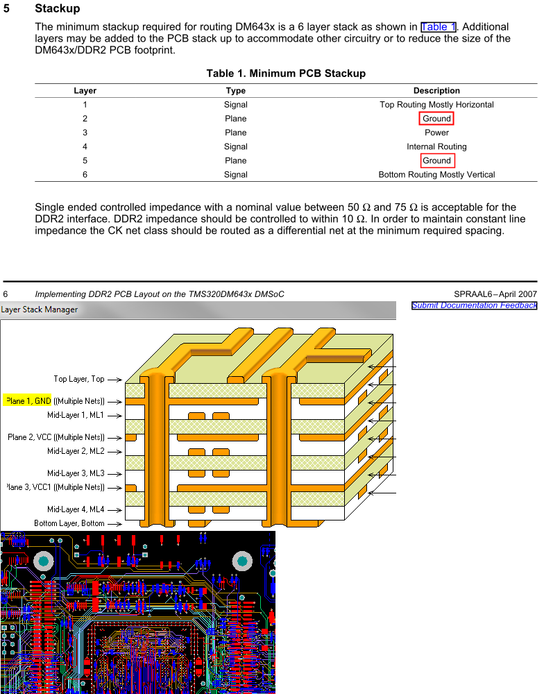

I would like to ask a question on DDR2 interface for DM6437.
SPRAAL6, Implementing DDR2 PCB Layout on the TMS320DM643x DMSoC, specifies in Table 1 – Minimum PCB stackup that there needs to be at least two ground layers in the PCB, but in EVM6437 I found only one.
Why is this and is this a problem in EVM6437?
