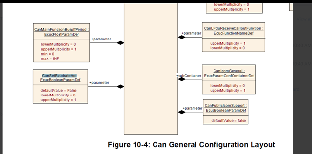

CanSetBaudrateApi used as list in Can Driver
MCAL: Jacinto - 7
In Can schema file CanSetBaudrateApi is used as container :
<v:lst name="CanSetBaudrateApi">
 <a:da name="MAX" value="1"/>
</v:lst>
According with autosar requirements this should be parameter
