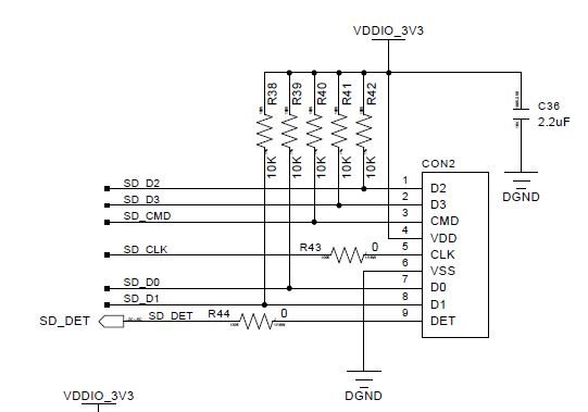

My customer assembled 200 custom boards, and found boot fail issue in 20 boards of these 200 boards using SD card boot.
But, all these 20 failed boards can boot well with emmc boot mode, and there was no issue in accessing SD card after emmc boot.
The SD card they used is 16GB SanDisk Ultra.
The following is the output when I run dss script and boot fail was occurred with SD card boot mode.

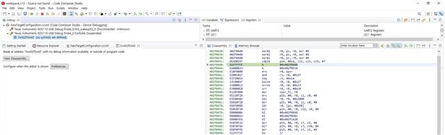

And, they connected CCS through JTAG and it looked the MLO was not booted.
Their HW schematic for SD card is as below.
Thanks and Best Regards,
SI.
  • SI, it looks like the code execution is successfully getting through the ROM but failing in MLO.  Trying using the tips here:  https://software-dl.ti.com/processor-sdk-linux/esd/docs/latest/linux/Foundational_Components_U-Boot.html?highlight=debugging%20tips#uboot-spl-debugging-tips
    to debug your MLO code and find out where in the code it is failing.  Have you modified the MLO from the original SDK?
    James
  • Yes. They modified SPL from the original linux SDK.
  • Thanks to your fruitful comments, I can dig-out their MLO code and found an issue in their DDR memory initialization and resolved it.
    Thanks for your support.
