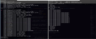

  • Hi Jianzhongxu,
    ex02_MessageQ
    I tried out the ex02_messageq example and updated the server.c to your attached code.
    I indeed see the "virtio_rpmsg_bus virtio0: msg received with no recipient", but it only occurs once in my dmesg output, but not constantly.
    When I start the ARM application as "app_host DSP", the DSP is still unable to open the ARM queue.
    In server.c the DSP is unable to move pass this while loop:
        Log_print0(Diags_INFO,"Server_create: server is ready");

  • Hi Jianzhongxu,
    Thank you for the detailed clarification.
    I managed to get an output similar to what you mentioned,.
     I also see the "virtio_rpmsg_bus" message constantly.
    The problem was that SYS/BIOS was using timer1 because Clock.timerId = 1 was defined in the Dsp.cfg script.
    I changed the applied timer to 3, then the ex02_MessageQ seems to run correctly on my board.
    I am guessing that timer0 and timer1 are reserved for Linux, and timer2 & timer3 can be used for SYS/BIOS.
    Thank you & Regards,
    Kim
