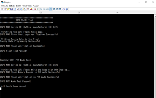

Hi Expert,
I'm trying to QSPI Boot using TMDX654IDKEVM.
software-dl.ti.com/.../developer_notes_sbl_boot.html
PROCESSOR-SDK-RTOS-AM65XX 07_01_00_14
Uniflash v6.2
I'm working with the following steps, but it doesn't work. I need your help.
1. Setting the Boot SW to "UART"
2. Find the COM port and execute the commands of Uniflash
C:\ti\uniflash_6.2.0>dslite.bat --mode processors -c COM7 -f C:\ti\uniflash_6.2.0\processors\FlashWriter\am65xx_idk\uart_am65xx_idk_flash_programmer.tiimage -i 0
Executing the following command:
> C:\ti\uniflash_6.2.0\processors\ProcessorSDKSerialFlash.exe -c COM7 -f C:\ti\uniflash_6.2.0\processors\FlashWriter\am65xx_idk\uart_am65xx_idk_flash_programmer.tiimage -i 0
For more details and examples, please refer to the UniFlash Quick Start guide.
ProcessorSDKSerialFlash CLI Tool
Copyright (C) 2017-2021 Texas Instruments Incorporated - http://www.ti.com/
Version 1.4.0.0
Downloading Flash Programmer..
Transferring File of size 161612 bytes
File Transfer complete!
Enabling System firmware transfer!!!
Header Transfer complete
Transferring System Firmware..
Transferring File of size 263072 bytes
C:\ti\uniflash_6.2.0>dslite.bat --mode processors -c COM7 -f C:\ti\pdk_am65xx_07_01_00_55\packages\ti\boot\sbl\binary\am65xx_idk\ospi\bin\sbl_ospi_img_mcu1_0_release.tiimage -d 3 -o 0
> C:\ti\uniflash_6.2.0\processors\ProcessorSDKSerialFlash.exe -c COM7 -f C:\ti\pdk_am65xx_07_01_00_55\packages\ti\boot\sbl\binary\am65xx_idk\ospi\bin\sbl_ospi_img_mcu1_0_release.tiimage -d 3 -o 0
Version 1.4.0.0
Transferring the Image to Flash Programmer..
Transferring Header Information..
Header Transfer Complete!
Flashing Image of size 153676 bytes
Flash Programming Success!
C:\ti\uniflash_6.2.0>dslite.bat --mode processors -c COM7 -f c:\ti\pdk_am65xx_07_01_00_55\packages\ti\drv\sciclient\soc\V0\sysfw.bin -d 3 -o 80000
> C:\ti\uniflash_6.2.0\processors\ProcessorSDKSerialFlash.exe -c COM7 -f c:\ti\pdk_am65xx_07_01_00_55\packages\ti\drv\sciclient\soc\V0\sysfw.bin -d 3 -o 80000
Version 1.4.0.0
Flashing Image of size 263072 bytes
C:\ti\uniflash_6.2.0>dslite.bat --mode processors -c COM7 -f c:\ti\pdk_am65xx_07_01_00_55\packages\ti\boot\sbl\example\k3MulticoreApp\binary\am65xx\sbl_baremetal_boot_test_am65xx_idk_all_coresTestApp_release.appimage -d 3 -o 100000
> C:\ti\uniflash_6.2.0\processors\ProcessorSDKSerialFlash.exe -c COM7 -f c:\ti\pdk_am65xx_07_01_00_55\packages\ti\boot\sbl\example\k3MulticoreApp\binary\am65xx\sbl_baremetal_boot_test_am65xx_idk_all_coresTestApp_release.appimage -d 3 -o 100000
Version 1.4.0.0
Flashing Image of size 9280 bytes
3. Setting the Boot SW to "OSPI"
4. Boot the TMDX654IDKEVM but it doesn't work

  • Hi Rei,
    Can you please confirm what is you Silicon Revision is it SR1.0 or SR2.0?
    Karan
  • Hi Karan,
    I appreciate your cooperation. This is a complicated situation.
    Customer confirmed with SR2.0. Then "Invalid magic number" occurred.
    I confirmed with my SR1.0 board. In case of SR1.0, it cannot be written to EEPROM (OSPI).
    I think revisions are also involved in the evaluation of OSPI. I should check it with SR2.0, but I have lent it to the customer.
    Rei
  • Hi Rei,
    I too do not have a AM65xx EVM handy as working from home. I'm checking internally with my colleague who has it to reproduce the issue.
    Karan
  • Hi Rei,
    I am able to successfully flash and run the prebuilt binary on my setup(SR1.0). I have followed the below sequence:

    As mentioned earlier, it is working on my setup. Can you verify whether OSPI diagnostic test is passing on your setup.
  • I did the OSPI diagnosis.

    Thank you very much. I used CCS to load the diagnostic images for OSPI and LED. These worked fine.
    (CCS can't load appimage, so I used .xa53fg)
    From the result, I think that the problem is in OSPI writing or Booting. Your image file is probably the same as mine, but I will check.
